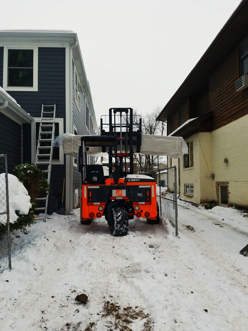

    There is a few type of moffets, some can go sideways, some has a nice reach that can offload a trailer on one side, some are small and go inside garages, and then there's regular moffets.
    Over here in the city of Chicago, most jobsite want material thru the alley, which is about 12ft wide. So a sideway or spyder moffett would be nice for any lumber over 12ft. Usually for me, since i don't have anything fancy, i leave it on the front lawn or take it back and get the special moffet to do it.
    just some jobs that needed a sideway moffetts.
    It depends on you if you need it
