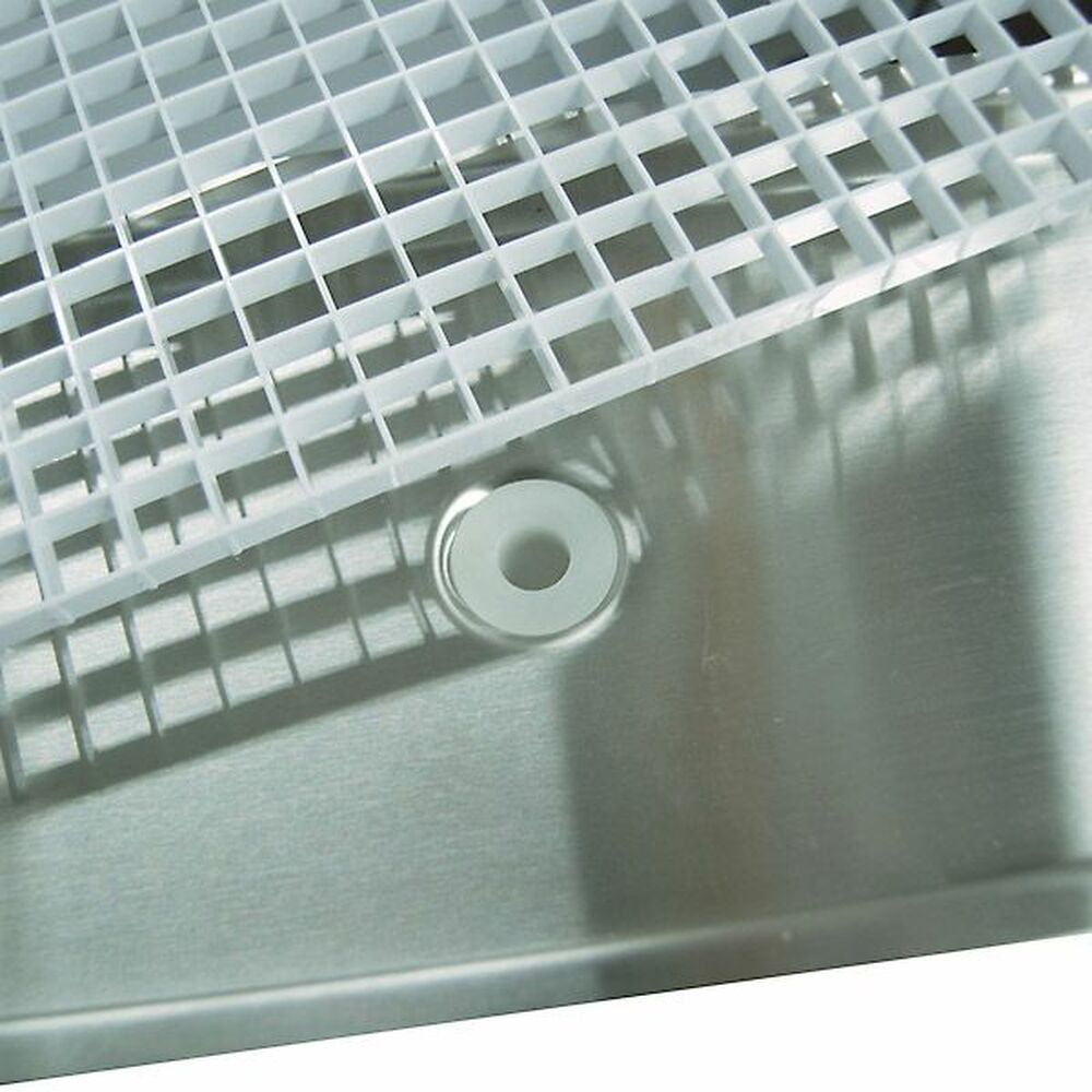

    I'm about to do this today, inspired by your post. But I'm wondering how you routed your water drain? I've got a turbo in my garage I'm thinking about pulling the dump off of it and drilling a hole in the bottom of the A/C, and then siliconing the dump to the bottom of it and drilling a hole in the floor to route it through.

    Cant say i know how he did it but id just get a drip tray about the right size for under it, plumb a hose connection to it at lowest point and drill a hole through the floor of the sleeper, then just run a hose so it dumps the water where you want it. (Bear in mind you need to have the door open or a vent bringing fresh air in/hot out in that little compartment)
    Example.
    14 7/8" Countertop Drip Tray - Stainless Steel - With Drain dt-5508-th-ssdrip-tray-b5_6__22266.1590770112.jpg fdt-5536-th-steeldripdrain-b2_6__70997.1590770112.jpg

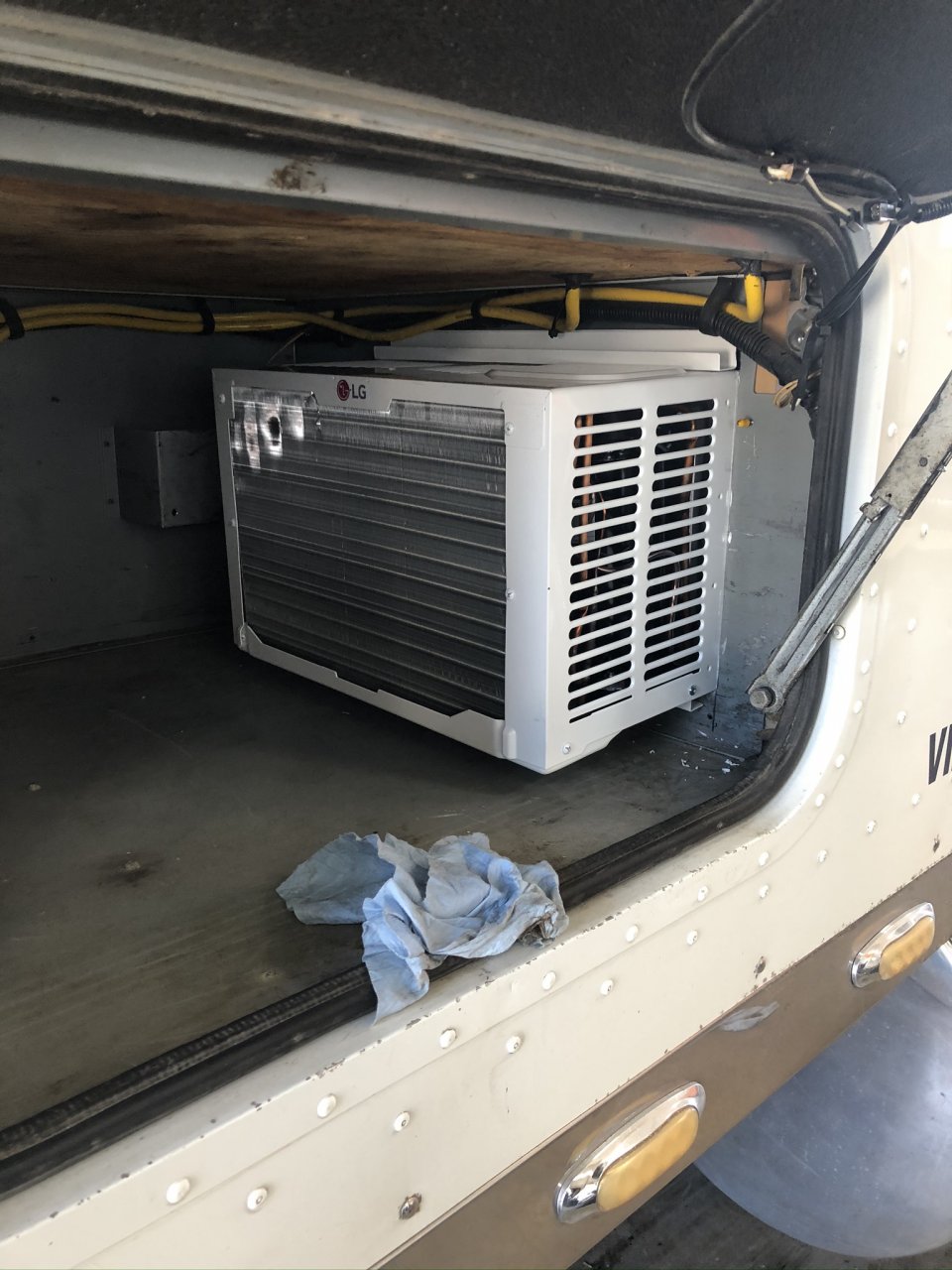

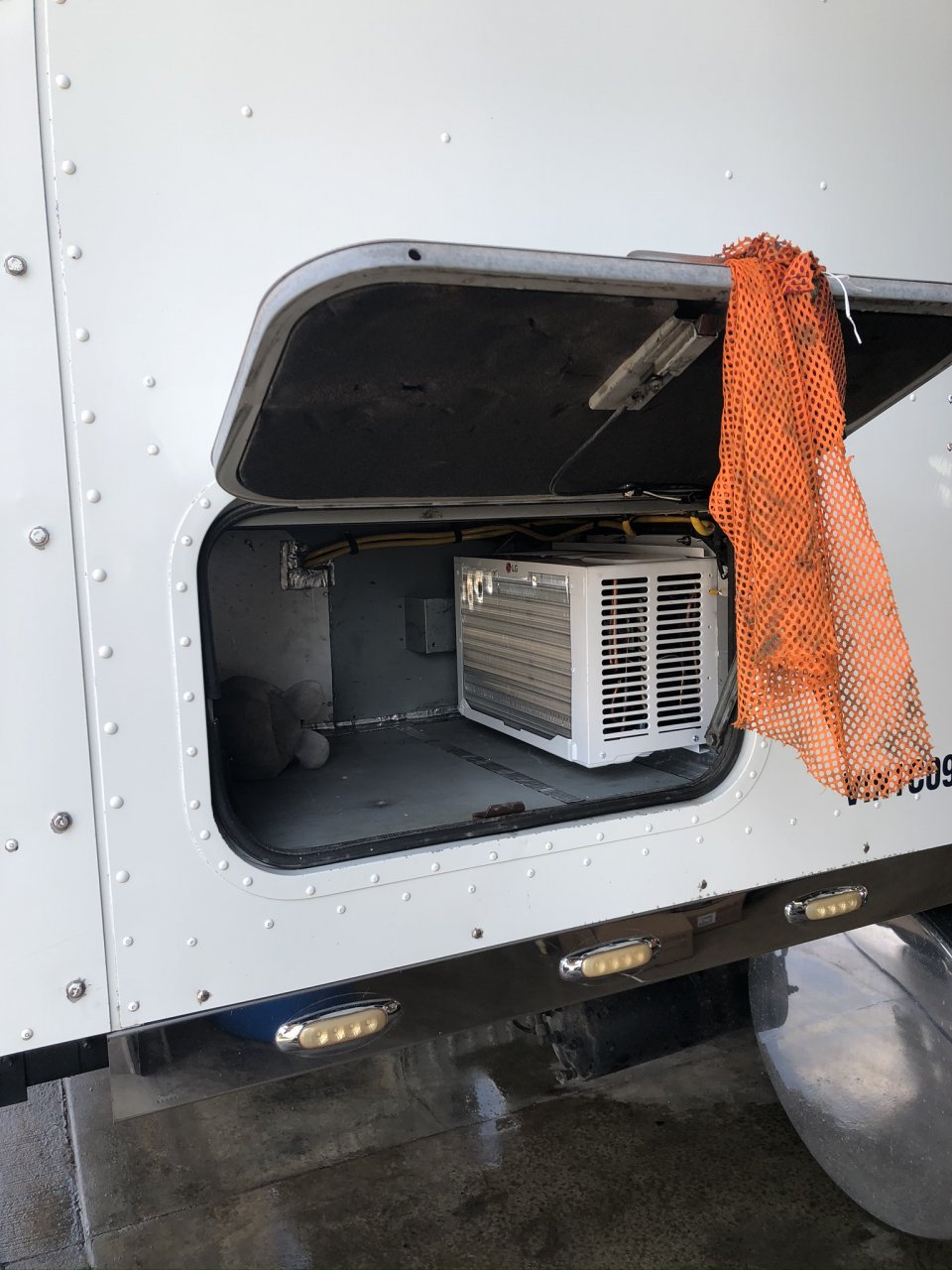

    Seems to have a slinger in the unit to splash it on to the condenser. Never had it it drip that I remember?
    But my cabs made out of aluminum so not to worried.

    I’ve seen a few setups on Docks down south. Where a window unit is mounted in a shed on the dock. All window units have Whats essentially a built in drip pan. They simple run a hose to a drain. Pvc fitting installed in the drain hole on bottom of unit. You can run 2, one at each corner. Or just 1, plugging the other. Tilt unit a bit accordingly. An extra drip pan could be made, to set the whole unit in, but I doubt its needed. Can easily add one later, If you have drainage problems. Tug Toys side box set up is ideal. So simple. A vented side door, and a small fan blowing across the coils, might make usable while Driving, with the side box closed. I’d like that, for when my Trucks A/C goes out. Till I can get it fixed.
