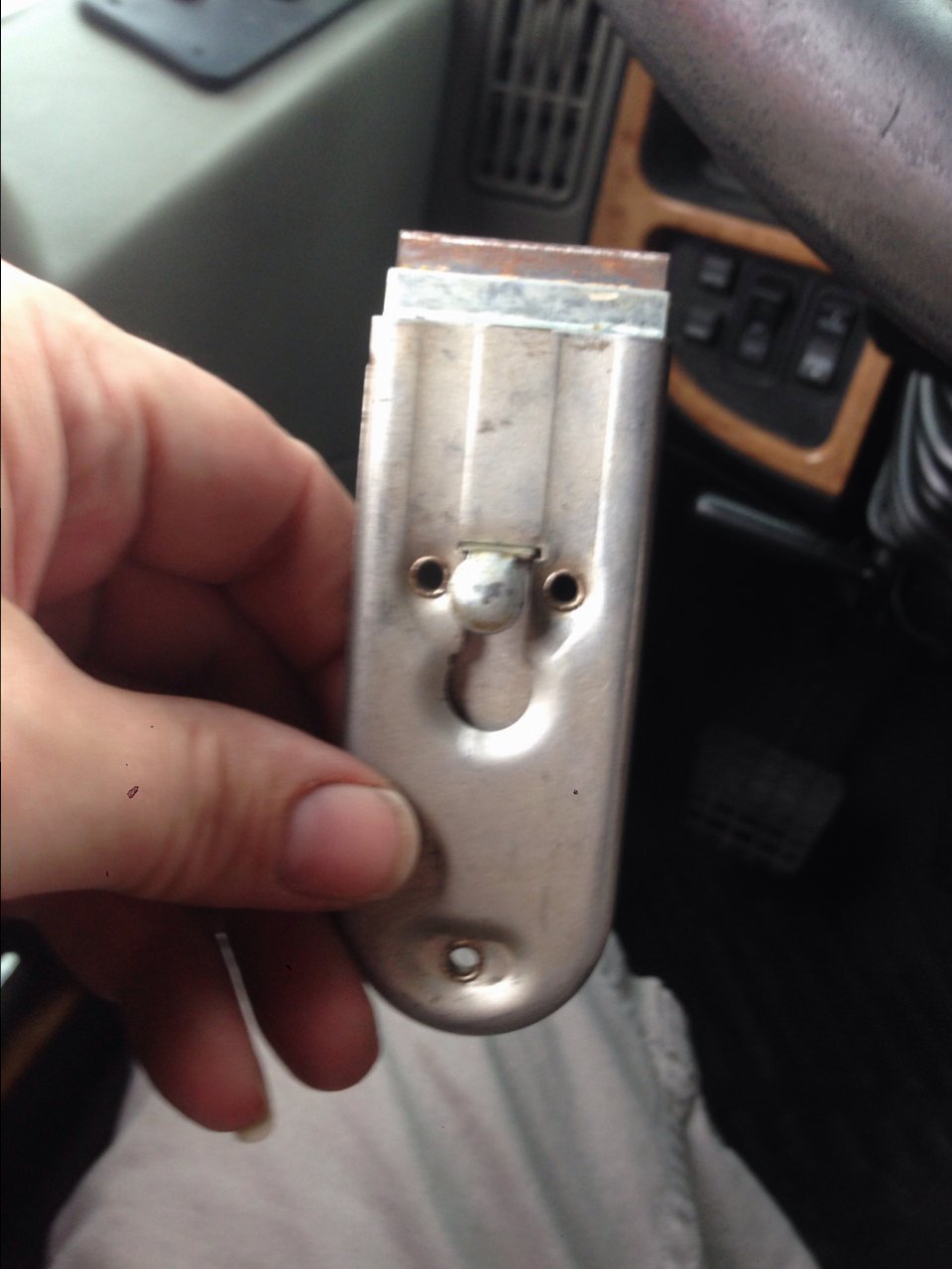

    Well, it may be worthwhile to keep something like that handy if one hauls containers frequently anyway. Depends on how ignorant those are to scrape.

    The workers in the port make you wish you were dealing with DOT. They will reject empties with remnants of the placard still on. Brake cleaner and the scraper shown above will take the placard off, 1,2,3. It will take the paint too, but who cares?

    I must have a magic scraper, it removes placards, with little effort.

    Here's my go to solution:
    Bean Jr. Thanks this.
  8. scottied67
    scottied67 Road Train Member
    10,826
    12,675
    Mar 14, 2010
    california norte
    dude,,,, trim those nails lol

  9. G.Anthony
    G.Anthony Road Train Member
    4,564
    5,973
    Dec 10, 2014
    what ever you do there driver, DO NOT commit suicide.
    that rusty blade will give you blood poisioning....then you might die.
