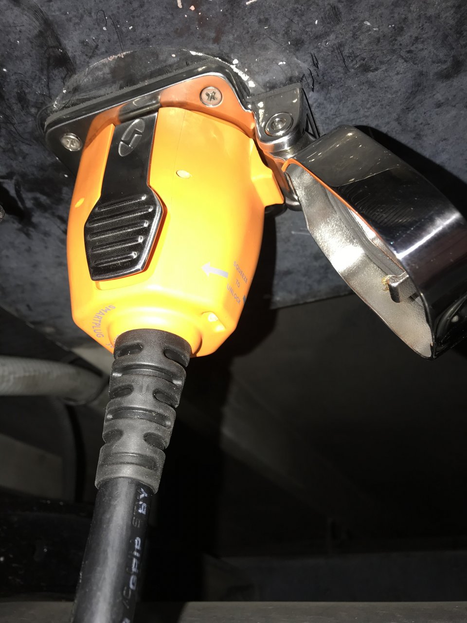

    Mine goes through the sleeper, and I almost had a fire one morning due to the older style RV connection that ICT used. I changed it out. I hard wired it to the shop fuse board with heavy guage wire on it’s own circuit.

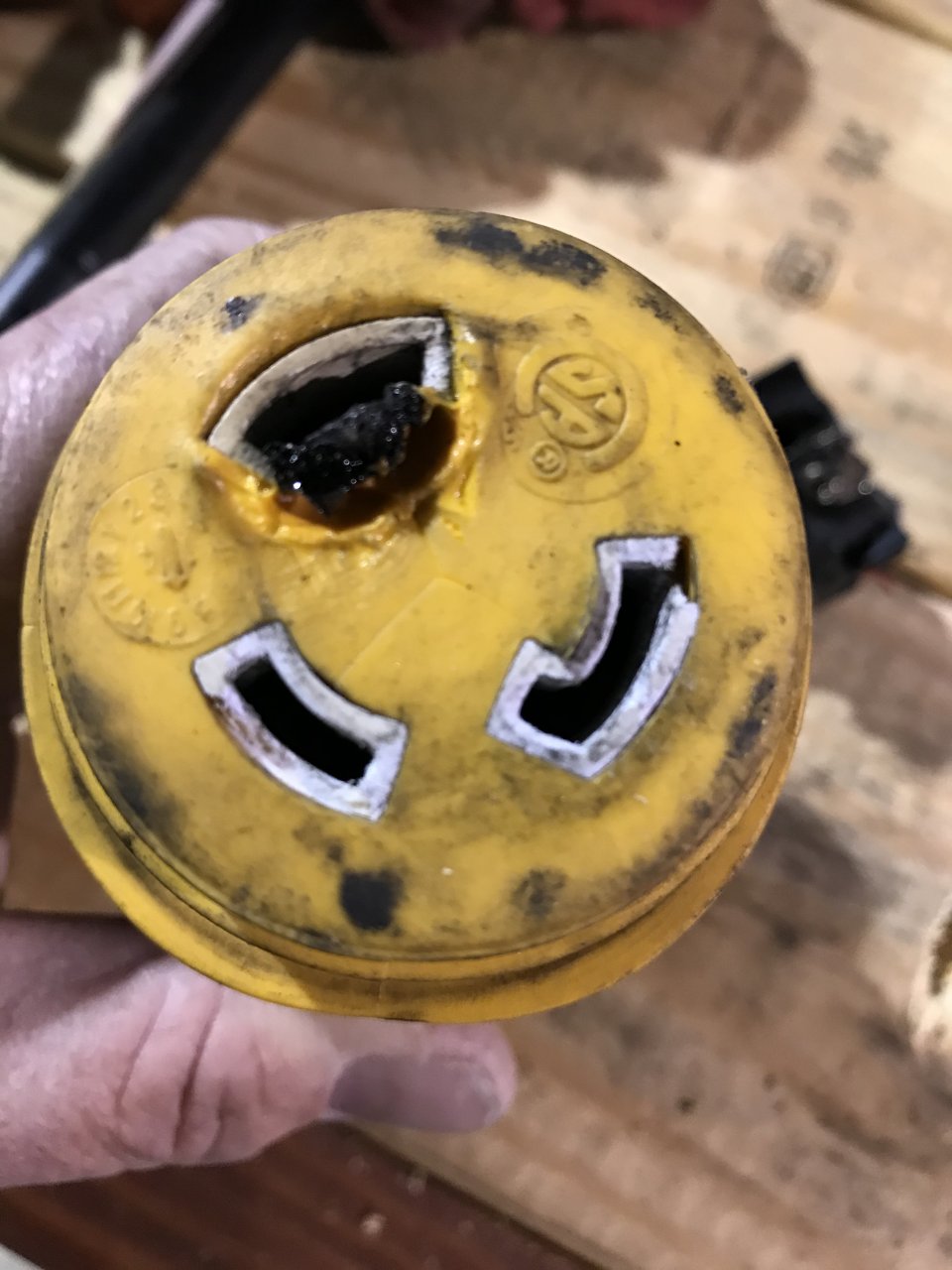

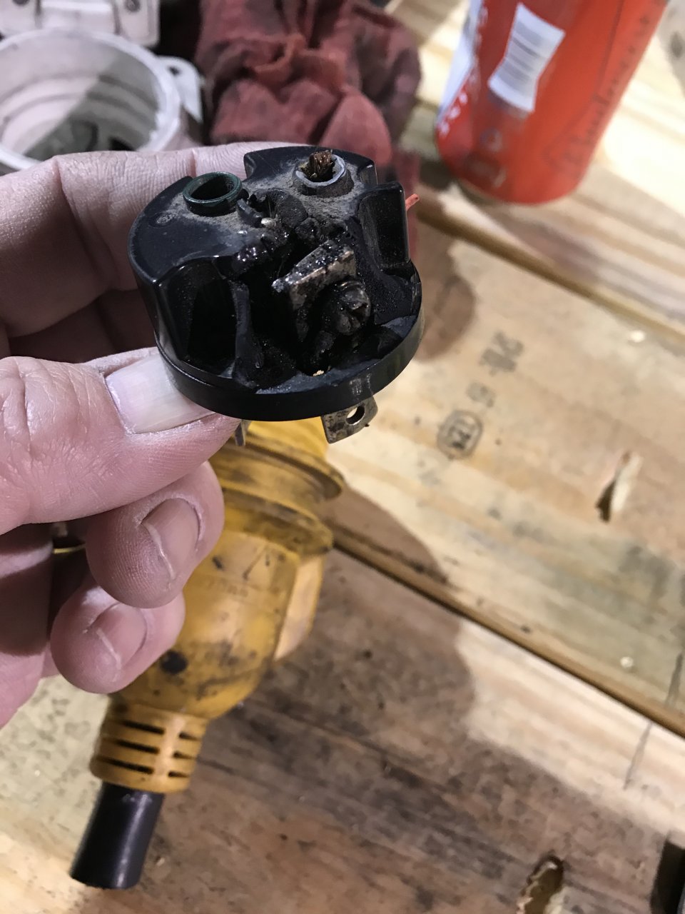

    Ouch that looks like it could had ruined the truck if not caught in time. Good thing it did not take your truck out. Mine is new at least so should not have any issues but will for sure give it. once over before I ever use it. I did when I first got it but that has been a few months back. Thanks again for all the extra information on this.

    Most trucks that I have seen with 20 amp receptacle have coolant, fuel and oil heaters or maybe a combination of at least 2 but never just block coolant heater alone. This is the reason for the additional amperage receptacle versus the 15 amp. Do not try to hook up 15 amp standard cord to this. It will melt and overheat the connection causing a potential fire hazard.
