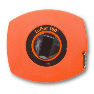

Forget holes when you are starting out! 100 foot tape measure is $17 at home depot:
http://www.homedepot.com/p/t/100205...ads-_-pla-_-100205133&ci_gpa=pla#.UZrIN5yNTIU
Lay it on the ground past the tandems. Then go back and make sure the "zero" end is right at the kingpin. Then go back and look where your tandems are. Or ask someone to hold the zero end where you tell them to.
It is also great to have in the truck if any LEO or DOT questions your length!
Once you have "taped" a few trailers you will know what holes on each make of trailer are what length. Wright the info down as you gather it.
