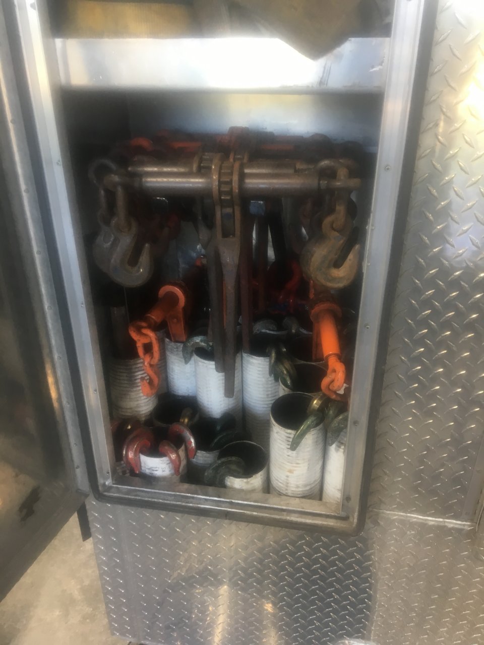

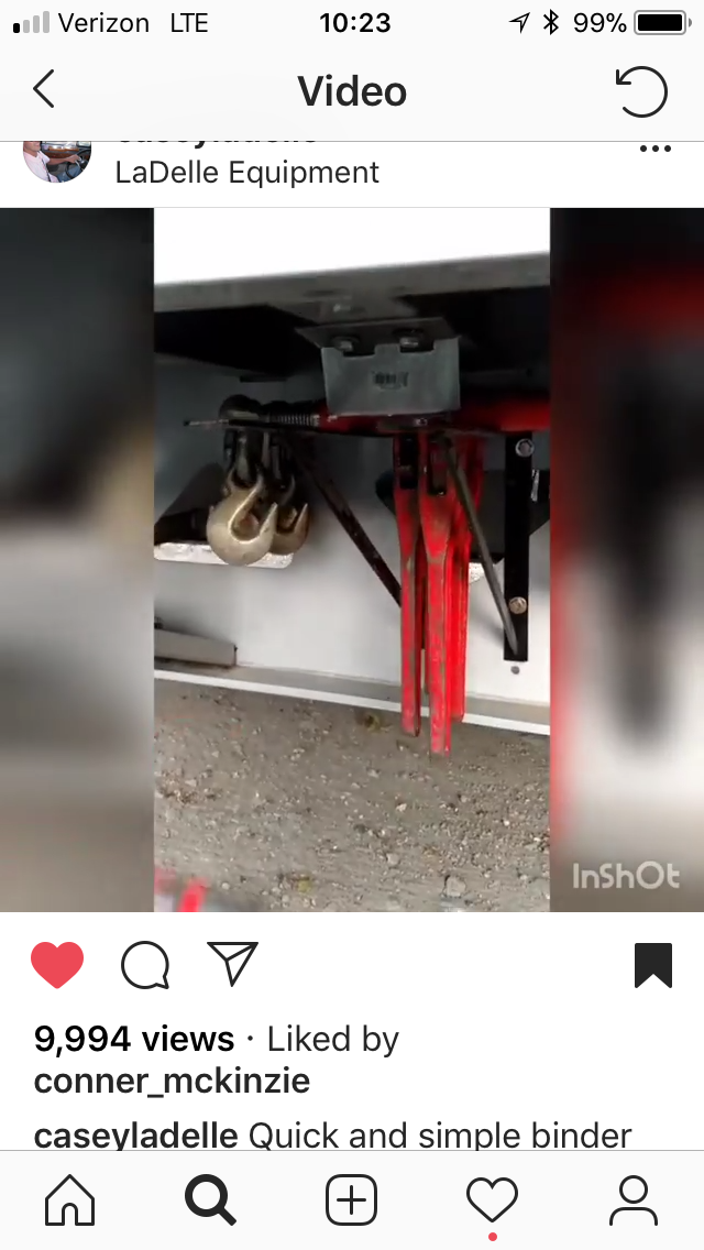

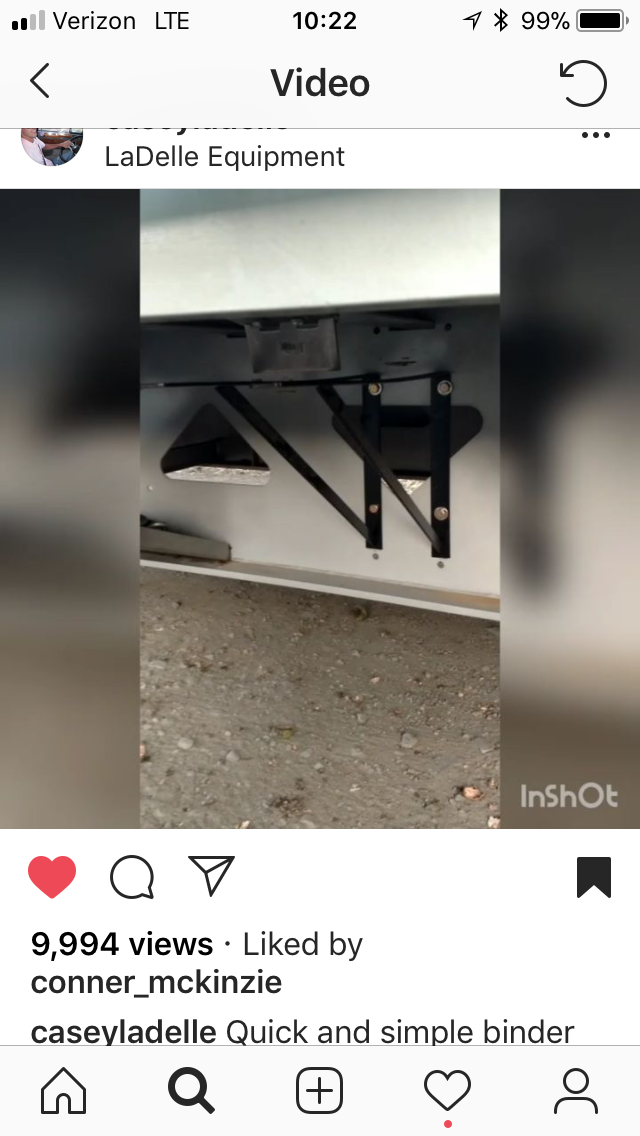

    Let her rip. Perfectly legal. I’m sure your wanting to hang snaps but I copied this idea from a guy for hanging ratchet binders.
    His idea: IMG_5178.png IMG_5177.png

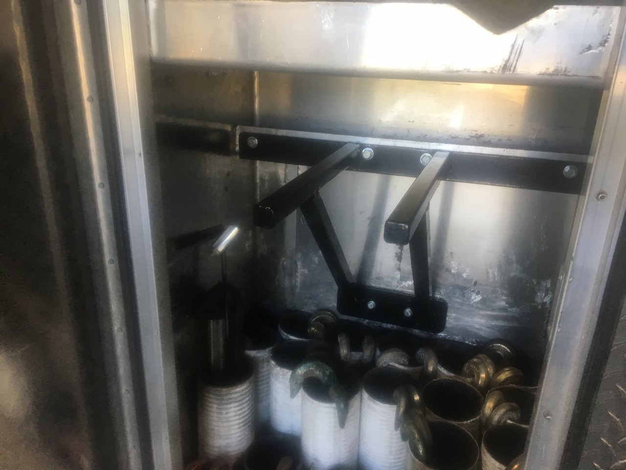

    my version for inside the headache rack. I use heavy wall 1” square tubing. IMG_7118.jpeg IMG_7119.jpeg

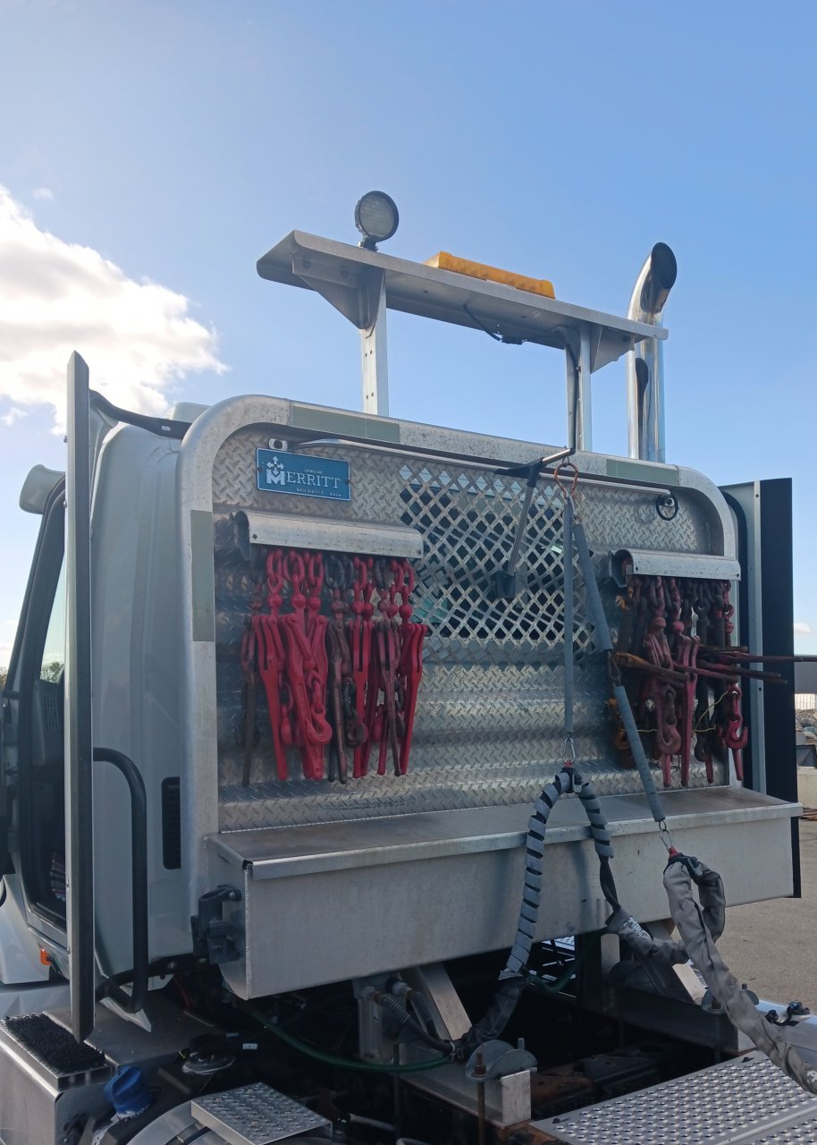

    That looks awesome. What I was picturing is one rack for snaps and possibly one for ratchets. Not necessarily these exact ones but something similar.
    Unfortunately, being that I am in a daycab with low roof, I am stuck with this fairly basic headache rack:

    I have 2 aluminum boxes, and currently stowing a dozen or so chains and all my straps in one, which is way too much weight. Other box contains tools, edge protectors and other odds and ends. My plan was to move the binders down to the frame, then hack that lid off my headache rack box and hang the chains on there to lighten up the box.
