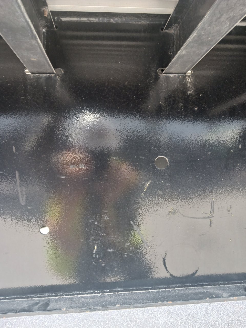

    Not going to get super into this, since most of the discussion is already had, but most of the time, the restriction for drilling into the webbing of the frame is that there are requirements for the size of holes and where they can be drilled. Granted, you don't want to weaken the frame and I'd go with other options, but the restriction more often than not pertains to where you drill those holes, and they often pertain to keeping it away from the curved webbing going into the top or bottom part of the I. Check with someone more knowledgable, as I see the same things you see, with things being drilled into frames...but again, I think the problem is where it is drilled....the curvatures to the top or bottom of the beam where it joins the flat.

    Yeah I haven’t been able to find anything specific as far as where and how big the holes can be. Just that you can do it on the webbing but not the flanges. I think a lot of that is up to the manufacturer to decide. I should probably reach out to Transcraft and see what they tell me. Either way I’m not in a huge rush so will definitely keep looking at options. I want to make sure I do something legal that will last.

    It is a transcraft steel frame/aluminum deck. It says 554C on the frame so I guess that is the model???
    I did reach out to Transcraft and he gave me a "should be fine." LOL... I'm not sure if I should feel reassured by that or not.
    He did suggest putting a backing plate behind it to prevent cracking.

    Of course he said it's ok. It's not his trailer and you'll be buying a new one. :)
    The backing plate is definitely a good idea, so it will spread the load over a larger area of the web, and it will help it keep from cracking, but also make sure there is some insulation to keep the metals from interacting and rust jacking...maybe add sealant to a rubber to keep moisture from getting between them and helping the rust process.

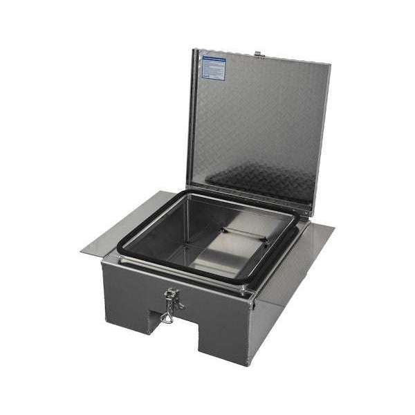

    From my understanding you can’t drill or weld the top and bottom of the I- beam, (flanges?) but everything else is ok.
    I had rebar bent in a U shape welded to the vertical section to hang snow chains on.
    The broken boxes - I reinforced the inside of mine with L- shaped sections - just drilled through, sandwiched the box material - I have 8 chains/binders and 2 bags of snow chains in a 24” step box, no problem.
    It’s a cheap fix to get more weight capacity out of them.

    That was my other thought - ‘gusset’ plate welded to the inside to prevent cracking.

    "Flange" is top and bottom of the beam , "web" is the vertical part
    (though technically trailers never use I beams, they use W or WF beams, or have fabricated beams)

    I was in a truck with one of those and loved it! I could keep what I used most in it and could always access everything right from the ground, hardly ever having to climb up on the back of the truck. Us old folks have to consider these things you know…
