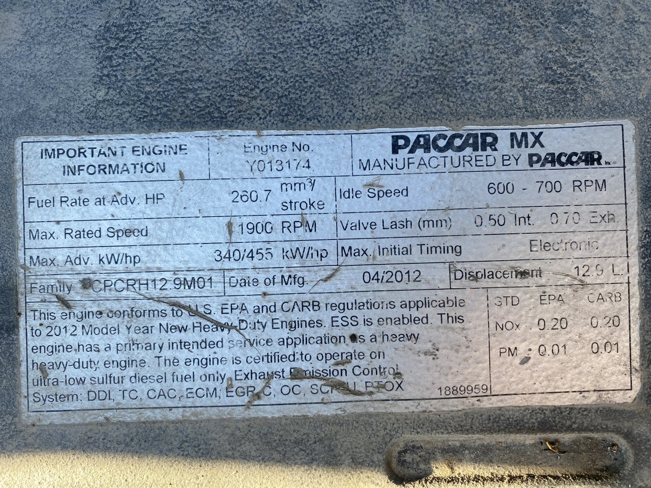

    I have paccar 13 with 455 with 10 speed can I put 18 speed for more power or/and boost up torque power or ? ….with 10 speed power power on the hills
    my setting 340-455 hp and set at 455 hp 4A243A1F-2115-4F29-9980-7E05407360B7.jpeg

    I believe they can’t raise the torque but can uprate to 485 hp same torque though. The 500 hp from those years use a bigger turbo. Seeing that your Canadian I’d talk to diesel spec out of Montreal about a non factory safe tune .

    But if u look at picture say only 340 to 455 …that means I can still boost up and I like to put better transmission in like 18

    Turn the fuel rail pressure up to 16lbs, speed up,don’t know max torque on Paccar, I’d say you could go to 1600-1650
    Most wont max them.
  7. AModelCat
    29,138
    158,288
    You're maxed out by the looks of it.

    A 13 speed will be more drivable because you can split the gears. Since it’s out of warranty I’d just find a place and see if they’ll put the 510/1850 tune in it.

    Check the torque rating on the trans.. most are 1,800. If so the max you can go is 1,750.

    If they turn up to 1850 they'll probably just sign a waiver saying it's on him if something goes boom

    To turn up through a dealership they have to send a request to another country who only goes by turbo and transmission specs . That’s why I recommended aftermarket through a known good company. 18 speed or 13 speed will only make a noticeable difference in top few gears. Being Canadian he probably hauls 100,000 lbs or 87000 lbs if a tandem.

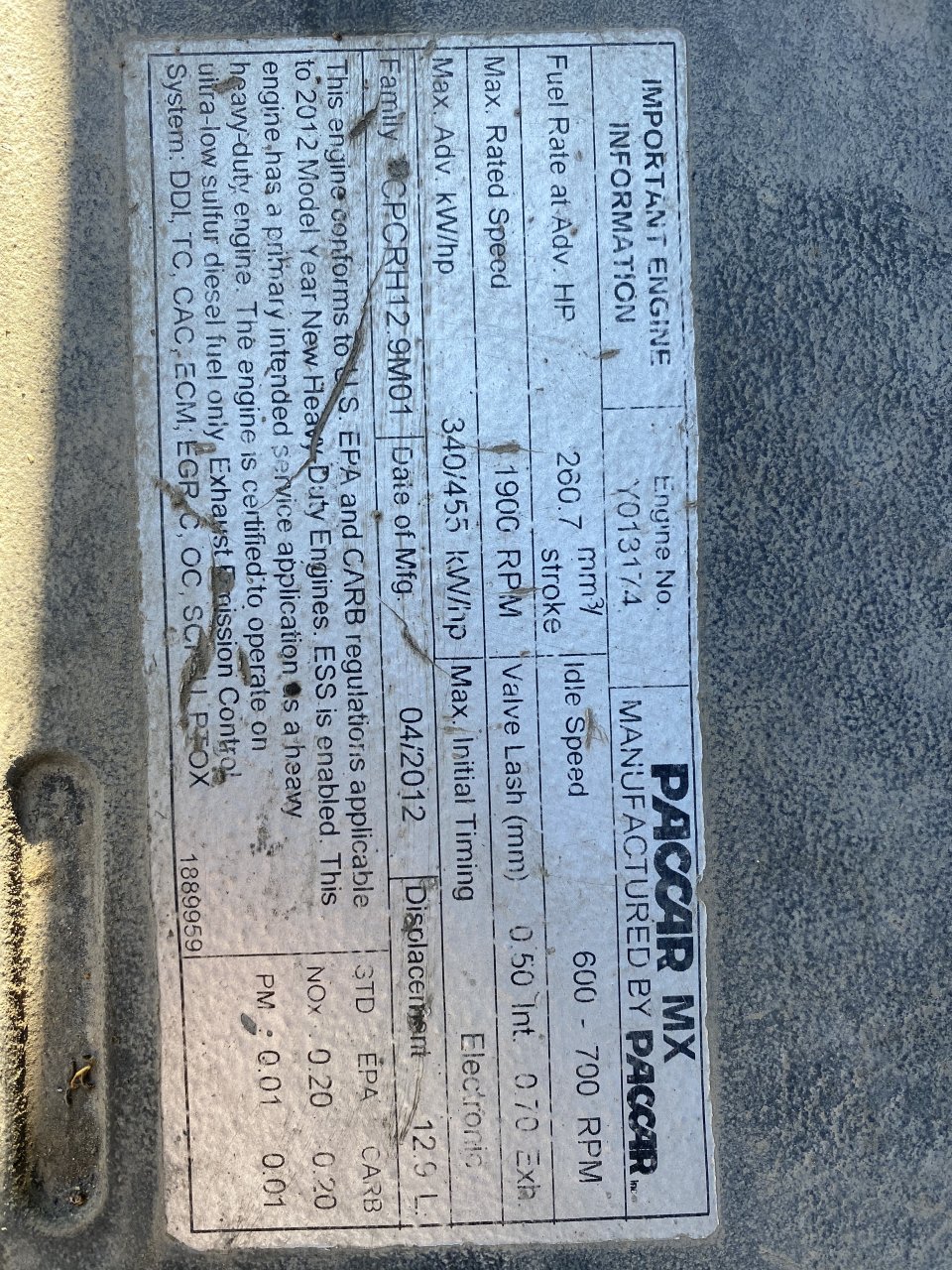

    Using a desktop computer. Had to reorient the picture.
