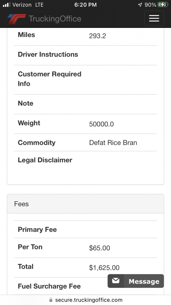

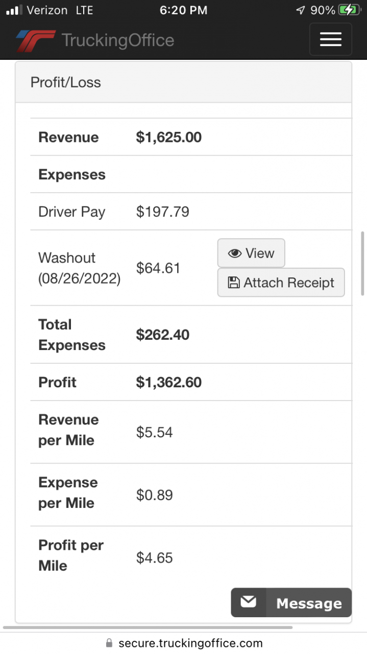

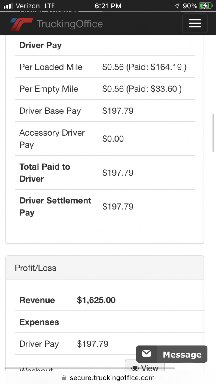

    Added Photos of load rate. B843805B-6AFB-4A16-84AB-5BFE35AE335C.png 945398A0-4258-4953-92C9-47A9E4887F8F.png 400F9D59-6619-460B-82D9-6FF78FAD05B7.png

    I set up a company, company gets paid, I work for my company at .56/mile just as if i was working for some other company at that rate.
    Company makes 4k plus/week.

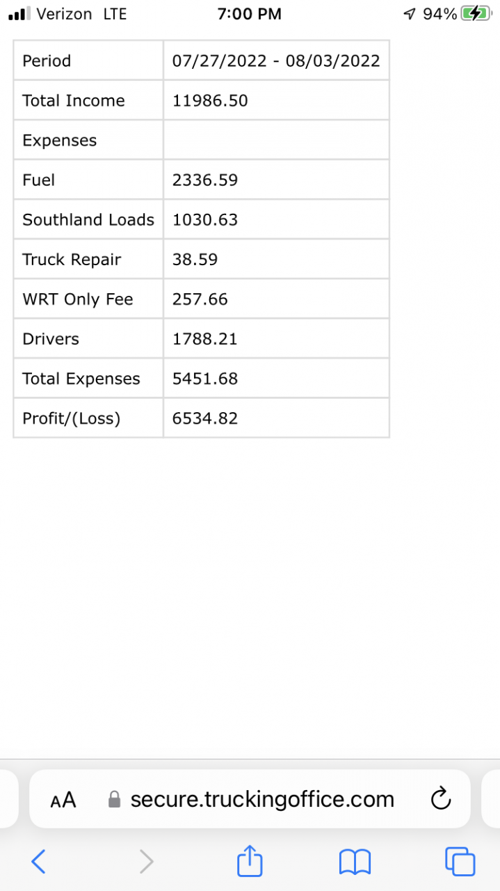

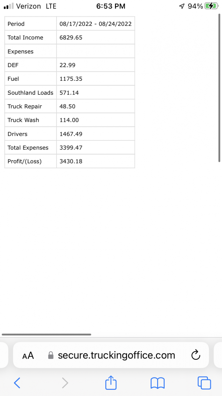

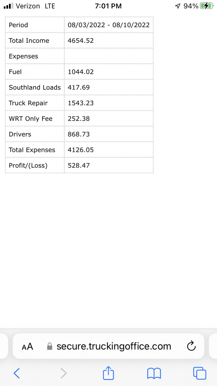

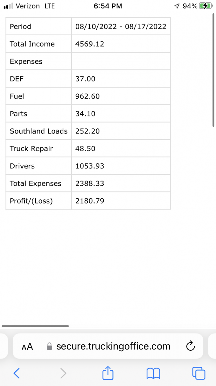

    I go Wed-Wed on paperwork, paid get money direct deposited Friday, sometimes the following Friday.
    Here’s the last few, expenses and all.
    B457A3AE-AD6B-4A5F-9199-28DFEA1707EF.png D18EFA1B-4A74-4226-ADD5-5801BA6F451A.png
    WRT is a direct shipper load, their cut which is 2.5% vs a brokers 10%.
