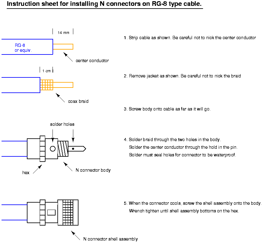

    The ends of the factory coax cable on my truck are split in half, CB still works fine but I was wondering if there was any way to replace just the ends? They're routed through the mirror mounts and really don't want to attempt to replace the entire cable

    Yes, I got one off Amazon. They sell either the solder type or the compression type.

    They also have screw on type. They work fine. Work exactly like cable tv coax ends. A dab of solder helps an the tip.

    Do I just cut the old end off and slide the new one on? Then solder inside where the wire comes through?

    Try and determine how much you can trim off coax,,,some provide very little extra coax, yes solder the where the wire comes through. If coax has been getting corroded use Silicone Caliper lube, its clear and sticks without bonding;)

    Yeah there's not much extra but I should be able to cut it and still have it reach. Thank you for the info
