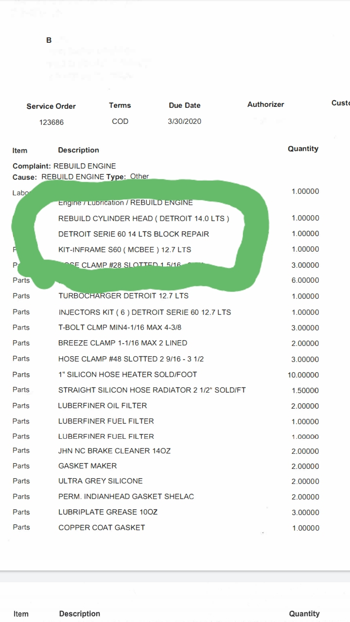

    Well I didnt look at those attachments, but good catch. Definitely a question to be asked to whoever is selling it.

    I forget exactly, but I think it was 1999, when Daimler bought Detroit. They started charging a premium to other manufacturers beside Freightliner. Few Dealers had them, basically special order for a couple/few years, after that had to buy a Freightliner to get a Detroit. The heads are all the same, the block repair listed must be a typo. I’m guessing it should read 12.7 counterbores cut. I was unable to open any of the links. Some research on the serial/ model number of the block will tell. It’s probably a BK engine. Or has been rebuilt with a BK Kit hopefully. If you have the Mcbee kit# , it can be looked up easily to tell. The older kits with lower compression pistons will have a lot of white smoke when cold, till engine warms up. The other thing you want to see is a new bull gear.

    I miss spoke, this is the engine
    051P-502-AAC DDC SER 60 ENGINE,430/470HP
    ENGINE S/N 6R0630761
    I love 379s for sure just not a fan of short hoods. Also, call me what you will but I like my creature comforts and would have to idle all the time until I could afford an apu . So I'm concerned about that.

    Agree on wanting to know when the bull gear was done last.
