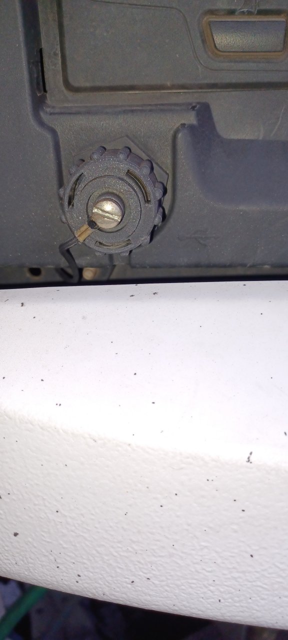

  6. AsphaltFarmer
    AsphaltFarmer Medium Load Member
    477
    759
    Apr 19, 2022
    New Mexico
  7. wichris
    wichris Road Train Member
    4,424
    9,053
    Jan 17, 2011
    Will need carrier's program to download it. Or take to a dealer.
    AsphaltFarmer Thanks this.
  8. bad-luck
    bad-luck Road Train Member
    3,357
    6,206
    Nov 16, 2013
    Baltimore, Maryland
    Correct lol
    AsphaltFarmer and nikmirbre Thank this.
  9. bad-luck
    3,357
    6,206
    Nov 16, 2013
    Baltimore, Maryland
