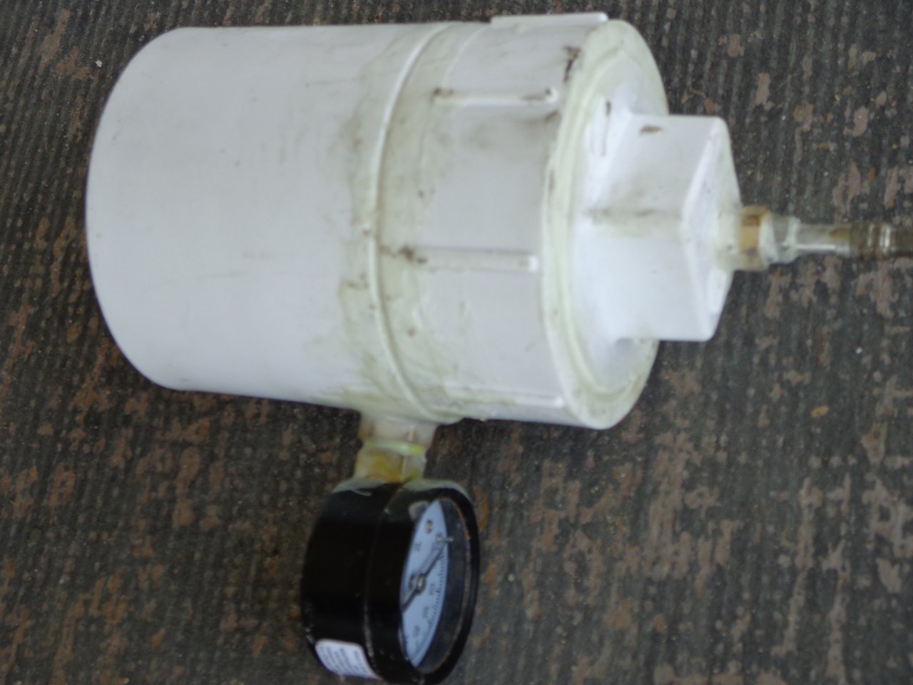

    It'd be pretty easy to make one if you've got a welder, torch and a drill and some pipe. Heck you could probably stop at a big home improvement store pick up some pvc pipe, a cab, pressure guage and a couple air fittings for under 87.56$

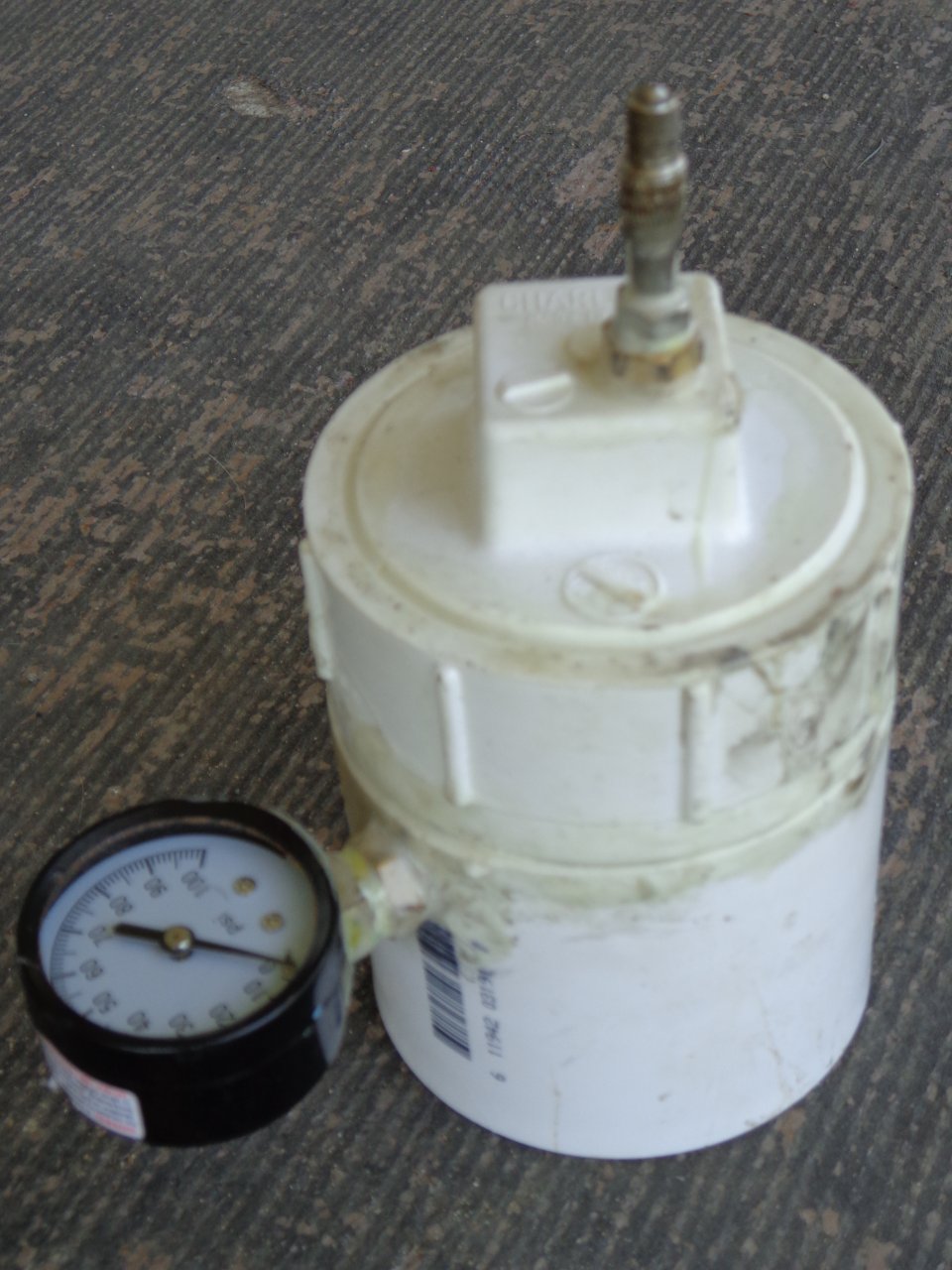

    This I did this with p.v.c. drain pipe, got everything from lowes. this works perfect on a detroit ser 60 not sure of the piping size of other engines.

    You cap off the inlet and outlet then pressurize the cac and see if it leaks.

    Thanks Heavyhaulerss, I assume you leave the boot on the openings of the CAC and use those to clamp on the fittings. Thanks for the Idea.
