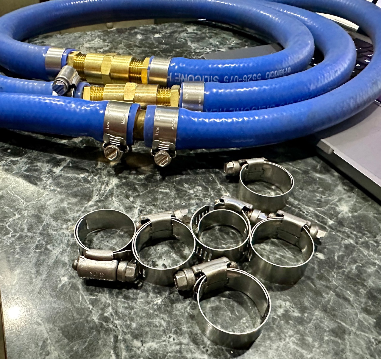

    I did most of mine a while back and had my mechanic replace ALL the truck with the blue stuff and good clamps (see the smooth band on the inside that doesn't bite into the silicone ).
    I had one - just one small half inch split off of the oil cooler that blasted out 5 gallons in 15 minutes driving, under an OS load, and it was enough of a PITA to motivate me to replace every last section .
    And the oil cooler piece that failed, was black rubber that we reused after the oil cooler repair. Seems to be common to have hose fail after it's been wrenched off then replaced.
    These are pieces I have looped up for repairs just in case.
