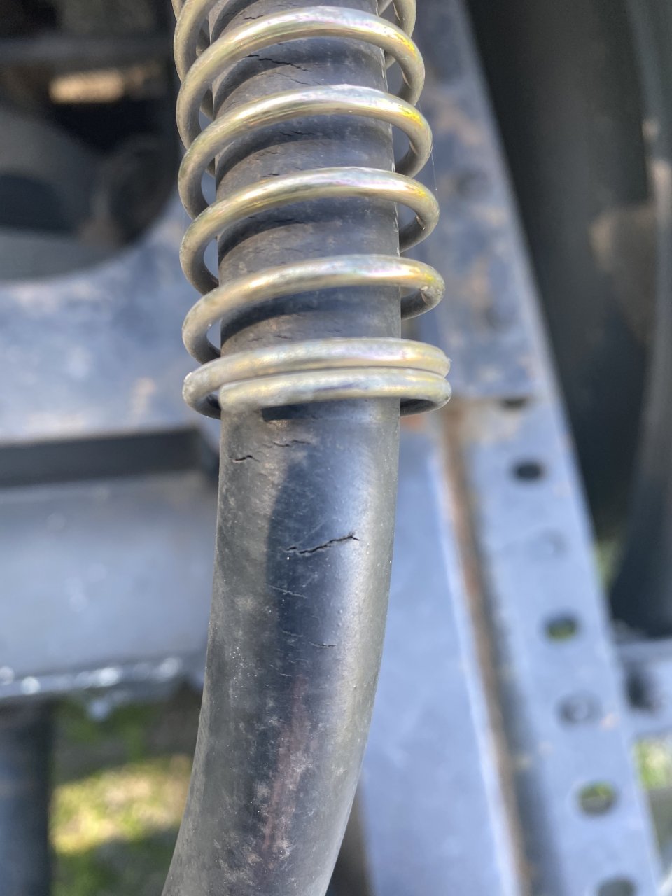

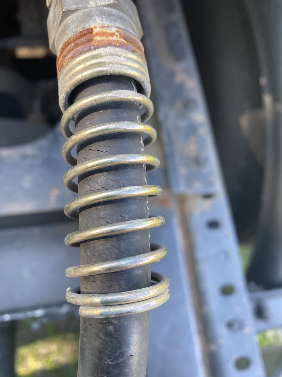

    As you can see below, I got some cracks occurring on my air line. This is the cab to trailer red side air supply going to the trailer. This is the part right before the gladhand. It’s the velvac brand and I only bought them about 2 years ago tops... for about $200 for the 3 in one bundle.
    Anybody know of a way to fix this? Can you fix this with a hose splitter/coupler kit? Or are those only for plastic? You can see there’s only one crack just past the springs that’s a little iffy. Or do I just buy a whole new set and do the install again.
    PS I think the weight is causing these cracks? I got the lines held up with 2 springs where I won’t touch the catwalk. So must of the pressure of weight is relieved, but there’s some still on it too of course.
    Thanks 84945DEF-C0AB-4AF6-9B90-0853885C0B4F.jpeg A6AB3F93-B64B-495F-B054-A173D3689F8D.jpeg

  3. okiedokie
    okiedokie Road Train Member
    13,308
    103,485
    Jun 13, 2011
    PNWET
    If it's cracked there it's probably cracked or will crack other places. Replacement.

  5. clausland
    clausland Road Train Member
    1,933
    11,067
    Dec 5, 2014
    North Woods
    I don't think the weight is causing them to crack, more likely UV rays, they're real tough on rubber. You'll likely need to replace them before the man sees them, sucks I know. There's various UV protectant sprays that'll help prevent this, or at least prolong their life...
  6. blairandgretchen
    13,610
    73,960
    Dec 9, 2011
    South west Missouri
    I’d just replace them.
  7. Doealex
    Doealex Medium Load Member
    597
    1,132
    Feb 21, 2018
    That’s why I use cheaper plastic coils. They will get discolored before they crack. But I agree, rubber ones look neater.

  9. truckdriver31
    6,998
    8,358
    Sep 18, 2013
    you can get hose fittings made at napa

  10. baha
    baha Road Train Member
    4,137
    2,837
    Jul 25, 2013
    ga
    Its best to replace them but if the hoses are long enough you can cut off the cracked end and take the pinch inside the end of hose and slide it on the cut off end then tighten it up?

  11. Rideandrepair
    17,424
    56,529
    Aug 8, 2015
    All you have to do, is take the fitting apart, cut the dry cracked part off, and re install, using a new compression Ferrell. Keep a couple extras, in case it ever happens again.
