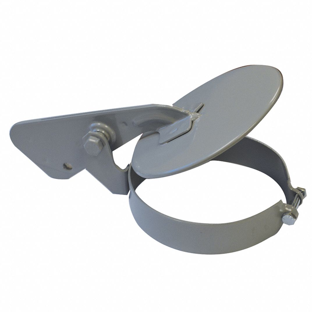

    So I recently started up my truck after having been sitting for a month with a Cummins ISM engine. We had a lot of rain here for the past few weeks and my exhaust pipe is prone to getting some water in there if it hasn't been moved.
    I start up the truck and immediately I see white smoke come out of the exhaust pipe. That's normal and it normally clears up after 2 minutes, but this time it continued to push out heavy white smoke for well over 5 minutes. I got no error codes in the cab so I shut it off. I can see water leaking out of the DPF filter, so is it possible the entire DPF filter is filled with water?

    Looks like steam, I can see water particles being spit out of the exhaust pipe and water leaking out of the DPF filter. Smoke would be more heavier, this was kind of free and moving around with the wind.

    My gut reaction would be, if what you see dripping is pure clear water, that what it is=rain water. If it was coolant, it would not be clear. Start it, run it till it clears up. If it never clears, then it’s an issue with the DPF system.
