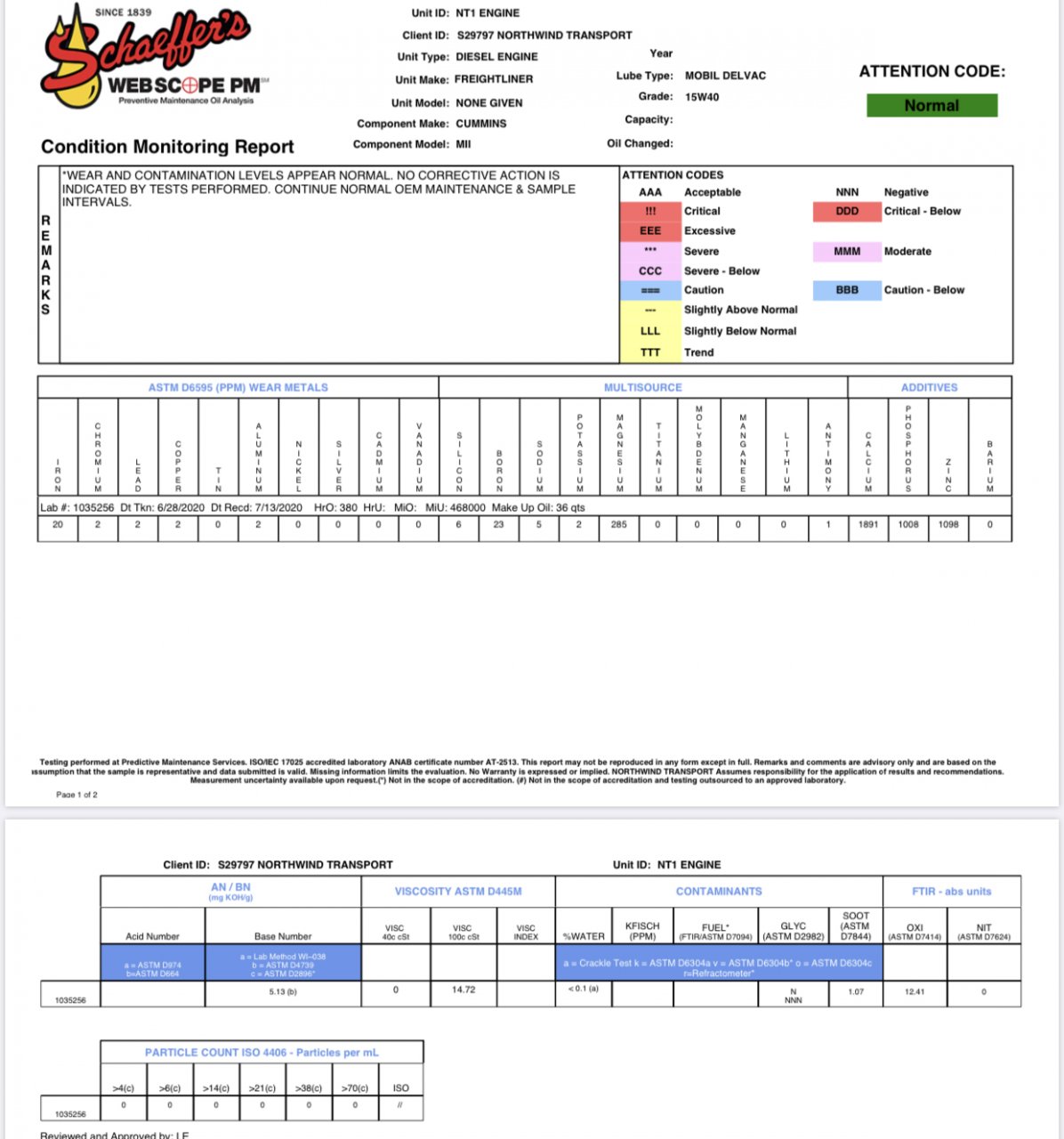

    Just got the oil sample analysis back from Schaefer's. It came back as "Normal" which I think is good because I ran the oil longer than I would have liked (close to 700 hrs). Here's a PDF of the results.

  7. blairandgretchen
    13,370
    71,810
    Dec 9, 2011
    South west Missouri
    That’s a real clean sample.

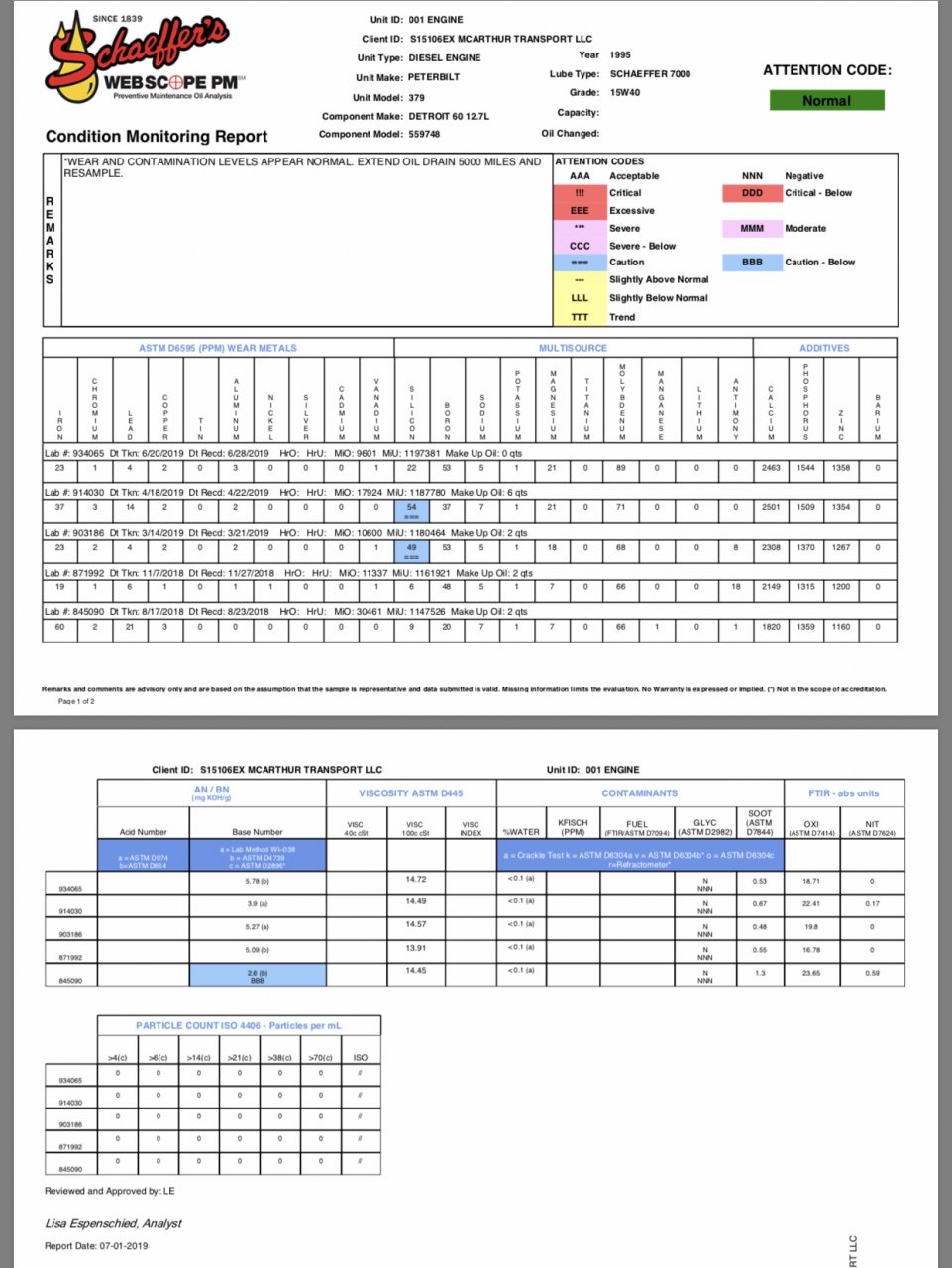

  9. blairandgretchen
    13,370
    71,810
    Dec 9, 2011
    South west Missouri
    Below is a running sample history for comparison.
    After looking again at yours - the soot is kinda high, but explained by that cylinder.
    Im not a mechanic, but I’d say replace injectors, oil - run a diesel treatment in fuel (I use Schaefer’s, but Howe’s will do), and go on.
    Oil at a gallon every 10,000 miles is fairly normal for these engines.
    More input from mechanics here appreciated.
    @Goodysnap ??
    Rideandrepair and TheBaron97 Thank this.
