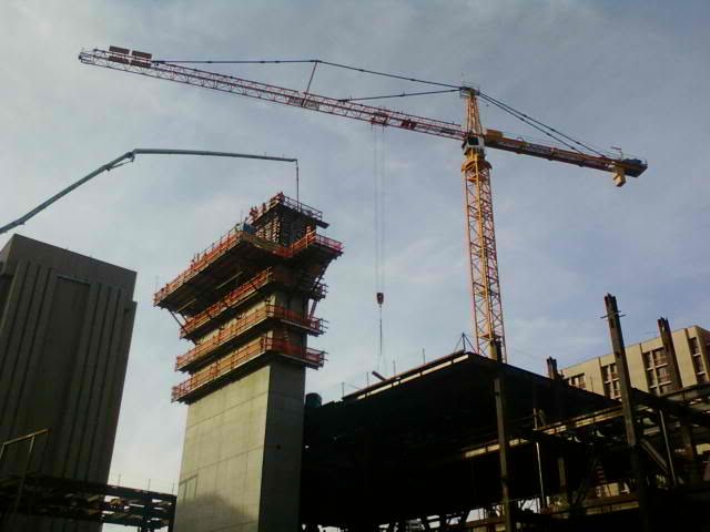

    some construction site photos of downtown San Diego,CA

    That big ol crane can only lift 45,000lbs!!

    only LOL
