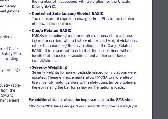

    Why can't, people, see this post # 4 and understand it? If you look close enough this question is answered. Here I will help you out! This is FROM the FMCSA!
    For this overweight to even GET to the feds it has to be listed on an inspection report. Look back at what I posted. It clearly says these violations will be cited. The FMCSA does NOT any longer place overweight tickets into the Cargo Basic. They are still cited and addressed if there is an investigation.
    Since they are not counted in the Cargo Basic they are also NOT counted in the PSP either. They may be listed, but there is no "score".
    OVERWEIGHT DOES NOT AFFECT CSA, PERIOD!
    Edited: As far as the driving record goes, it depends on the state. In the US most states do NOT consider overweight a moving violation. To fully answer that question the question MUST be narrowed to an actual state. Blanket statements on this MVR topic can't be answered.
