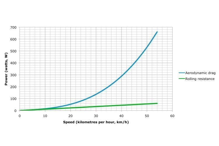

    It depends on more than some pre-determined speed. It depends on the required horsepower needed to keep a truck moving at that speed. So now, are you going eastbound? Wind generally is west to east. Did you just crest the hill east of laramie wy? It is a slight downhill all the way to Omaha. These will be your 2 biggest changing variables when it comes to determining what speed will use the least fuel.
    The other half of the equation is what price you're paying for fuel, pre ifta. That is the easiest way to cut your fuel cost. There's lots of threads on that. If you're a company driver you probably don't know the actual price your company is paying after their discount. But you can calculate for your own mental exercise should you be considering owning your own someday. To learn how it works, at least.
    The time saved is often not worth the extra expense. The difference in an average speed of 70 vs 60 for a 2500 mile load is only 2:45. And if you schedule your delivery time at 8 am instead of 3 am you have some extra wiggle room. Or you can schedule it as if you have a perfect world and if you manage 70 you will be right on the money. Good luck...
    A general rule of thumb is ever 1 mph above 55 will cost you about .1 mpg. If you try it over the long run.... It is not complete b.s. if you've ever seen the charts showing horsepower required as speed increases, you'll see the wind is the #1 pushback rising faster than terrain and tire resistance as speed increases. Ever try to maintain 65 in a very strong headwind and can only manage maybe 60? So find your happy medium and roll with it. I like 62-64 When I go west and when I come back east I prefer 70-75 where the situation allows. If you have a pyro and egt gauges you can get good at this game and have more consistent fuel mileage while varying your speed for conditions.

    The simplest explanation is that when you increase the speed, the air resistance (drag) increases much quicker than the speed, demanding more power and more fuel.
