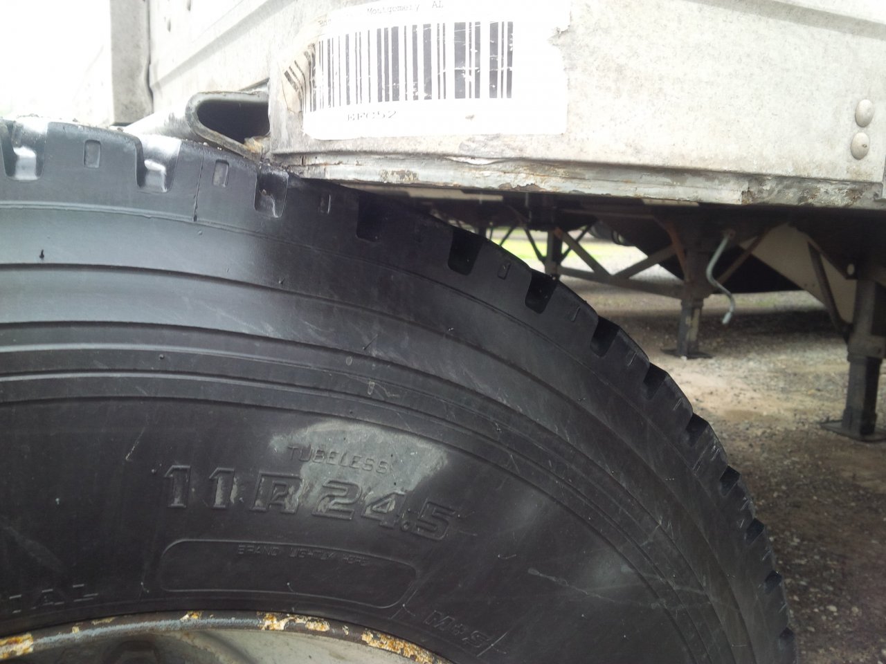

    Thanks, #######. Next time, crank the legs 'til they touch the ground... IMG_20150425_082046.jpg

    That one was either dropped with the legs around 5 inches off the ground or on an uneven surface and moved. I would bet the latter. Don't take it personally.
