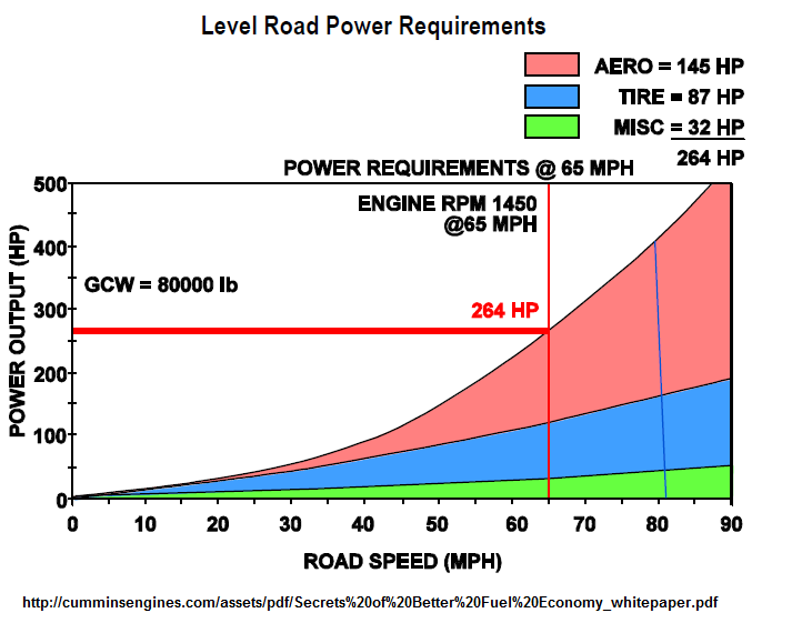

    The "average" truck (according to Cummins whitepaper) uses 320 horsepower at 70mph vs 180 horsepower at 55mph:
    Horsepower and fuel consumption (per unit of time) are correlated, so:
    70mph truck uses 78% more fuel per same time ( (320-180)/180 )
    70mph truck goes 27% farther in same time ( (70-55)/55 )
    So in 1 hour, your 6.2mpg 70mph truck would burn 11.3 gallons (70/6.2) and go 70 miles. In 1 hour, the 55mph truck would have burned 6.34 gallons ( 11.3/ (1 + 78%) ) and gone 55 miles (55/6.34= 8.7 mpg)
    16,100 gallons/year 70mph
    11,500 gallons/year 55mph
    4600 gallons/year ($9,300-$23,000 per year fuel savings at $2-$5 per gallon)
    In addition to fuel, maintenance costs are also correlated to power (just think of drive tires alone -- going 1 mile putting down 180 horsepower vs 1 mile putting down 320 horsepower)
    That said, if you need to get there by a tight deadline, by all means, drive as fast as is required (within reason). Likewise if you know you can get reloaded in the same day if you hurry, hammer down. But racing to get a front-row spot at the truck stop where you'll sit for 12 hours just doesn't make much sense to me...

    A truck geared to run optimally at 70mph is, at worst, going to be maybe 200rpm off of optimal at 55 mph. That means instead of a BSFC of 0.320 you might be at 0.325 -- a whopping 1.6% inefficiency compared the the 40% gain in efficiency at the slower speed.

    I had to think about this a minute. Are you sure percentage horsepower = percentage fuel consumption ? Something is amiss here, I do not see this much variance from 55 to 70.

    Roughly equal. Look again at the BSFC graph:
    So for that 1994 12.7 detroit at 320 horsepower, the BSFC is ~0.310 at peak efficiency (1400 rpm). At 180 horsepower, the BSFC is ~0.325 at peak efficiency (1400 rpm)
    320 horsepower * 0.310 lb/bhp-hr = 99.2 lb of diesel burned in an hour (~7lb/gal ~= 14.2 gallons)
    180 horsepower * 0.325 lb/bhp-hr = 58.5 lb of diesel (~=8.4 gallons)
    (14.2-8.4)/8.4 = 69% -- which isn't terribly far off from the 78% we'd estimate if we assumed perfectly equal BSFC.
    On perfectly flat ground, my truck does ~9.3 mpg at 55mph vs ~6.8 at 70. The more aerodynamic your truck, the less variance you'll see. Here's what that cummins power graph would look like with just a trailer tail (~10% aero improvement, no change in other resistance):
