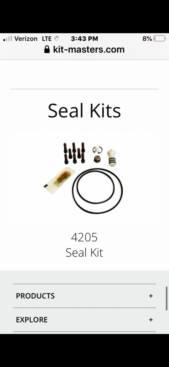

  9. Rideandrepair
    17,344
    56,270
    Aug 8, 2015
    13CEAE37-B955-47C7-B783-145D4C0882CA.png Hers an example of the mini kit. Usually 2 types of fans. 1 engages and stays engaged when air line is disconnected. Just crimp the line, by folding it over and tape or zip tie. Stops the leak and fan stays engaged always. Other type uses a bolt to lock it in full time till you can get it replaced. Carry a bolt in the glove box. No need to be stranded with either type.
