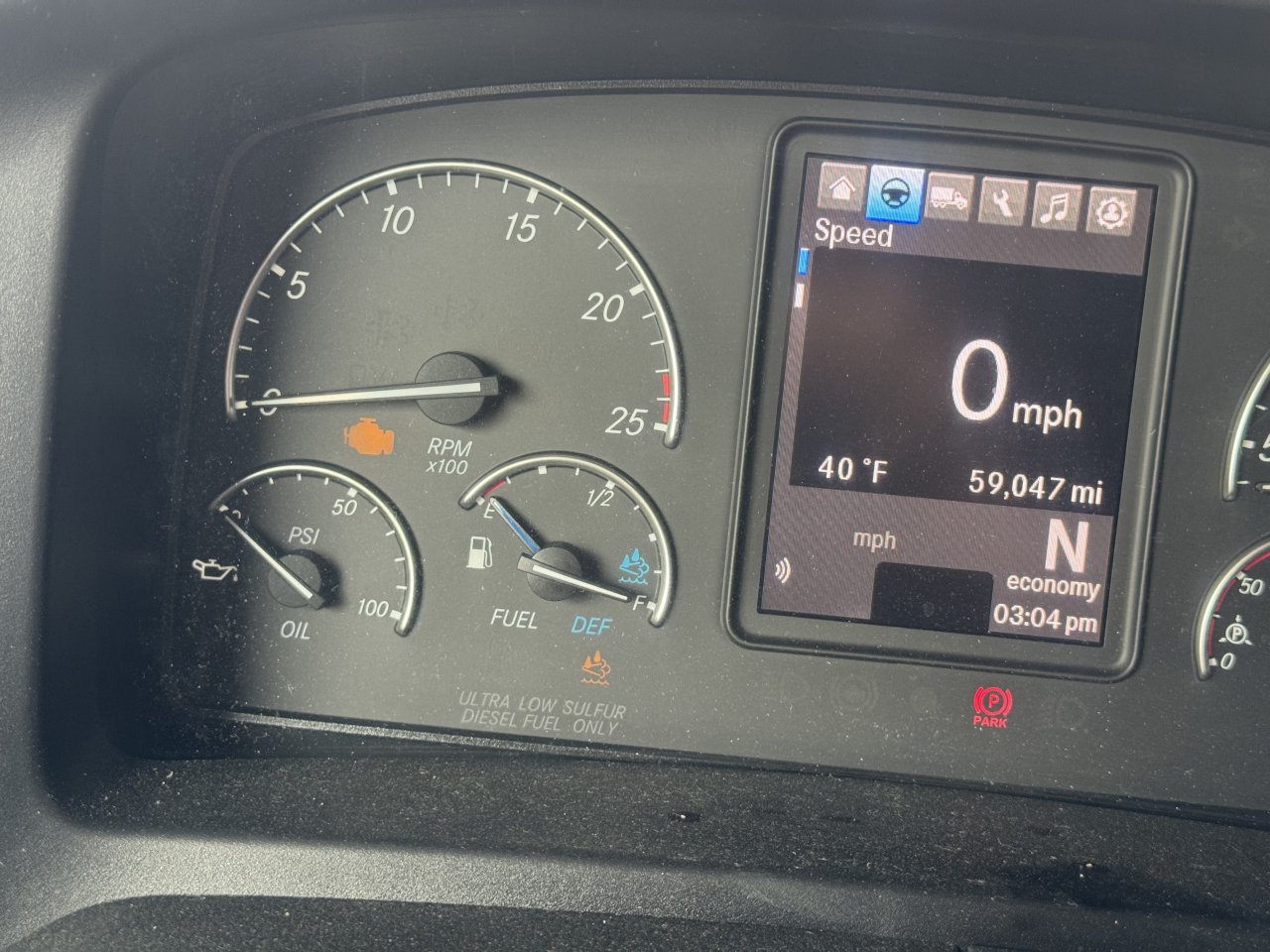

    The DEF header is probably on vacation. At least it's a warranty repair. This is a national problem. DEF systems are a joke. And the part is likely on backorder. If it starts flashing or beeping, find an exit or a good place to pull over. There are two malfunction types. One of which is derate and eventual shutdown, which you will absolutely hate. When your ECM thinks you are out of juice, you are stuck waiting for a tow. Get this into the shop. I am sorry this is happening to you.

    I would get that into the shop asap.. cause it seems like your sensor is going bad and that def level sensor is a sensor that goes out frequently on all these trucks. Basically it’s telling you that it’s gotten less def than what you actually have and it will shut you down eventually… and I had them go out on my Peterbilt just as frequently FYI
