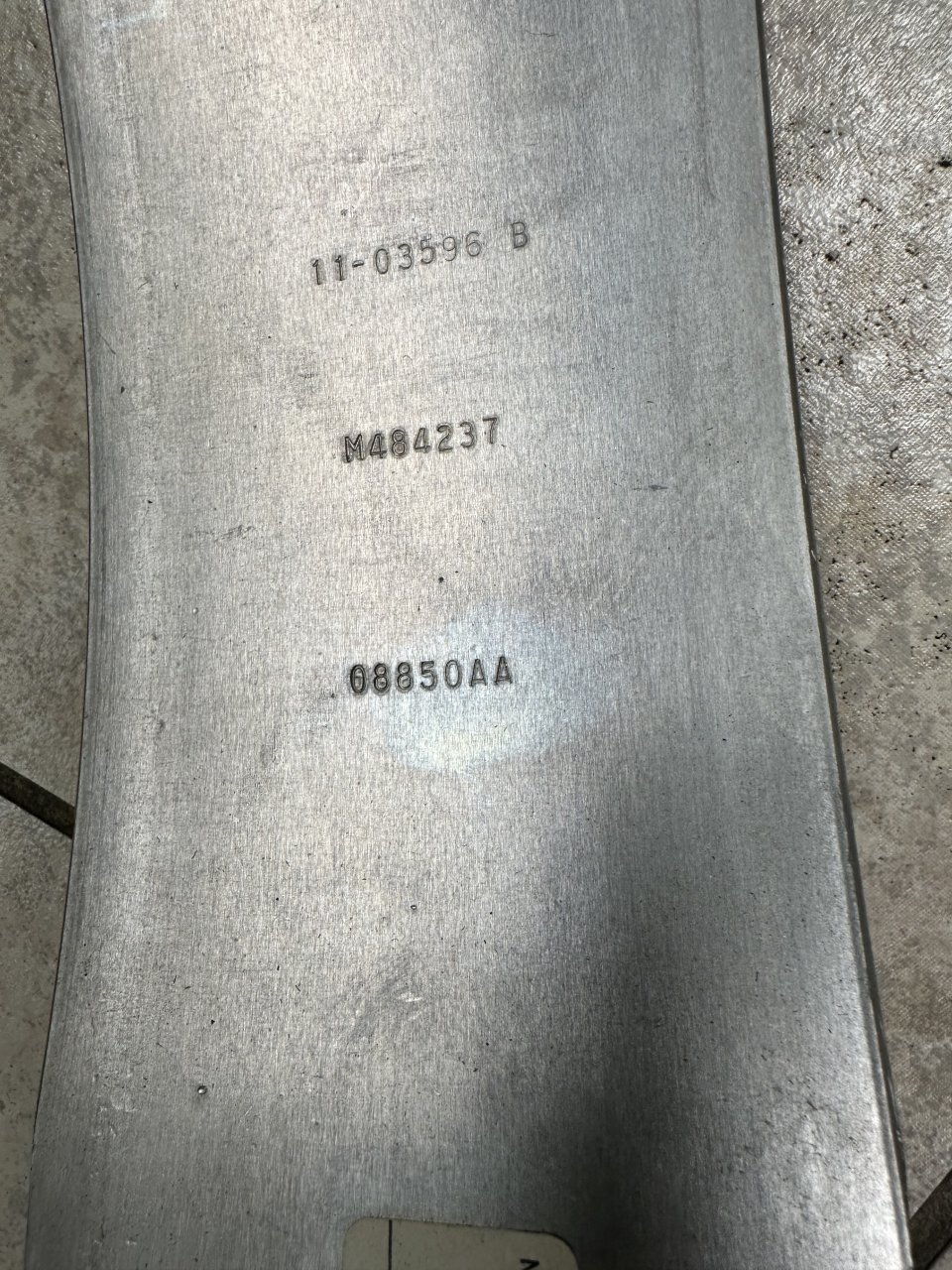

    Here is the stampings on the interior face of the strap they had available - aluminum.
    Here's the part number of the tank straps I was supplied with, obviously an aftermarket part.
