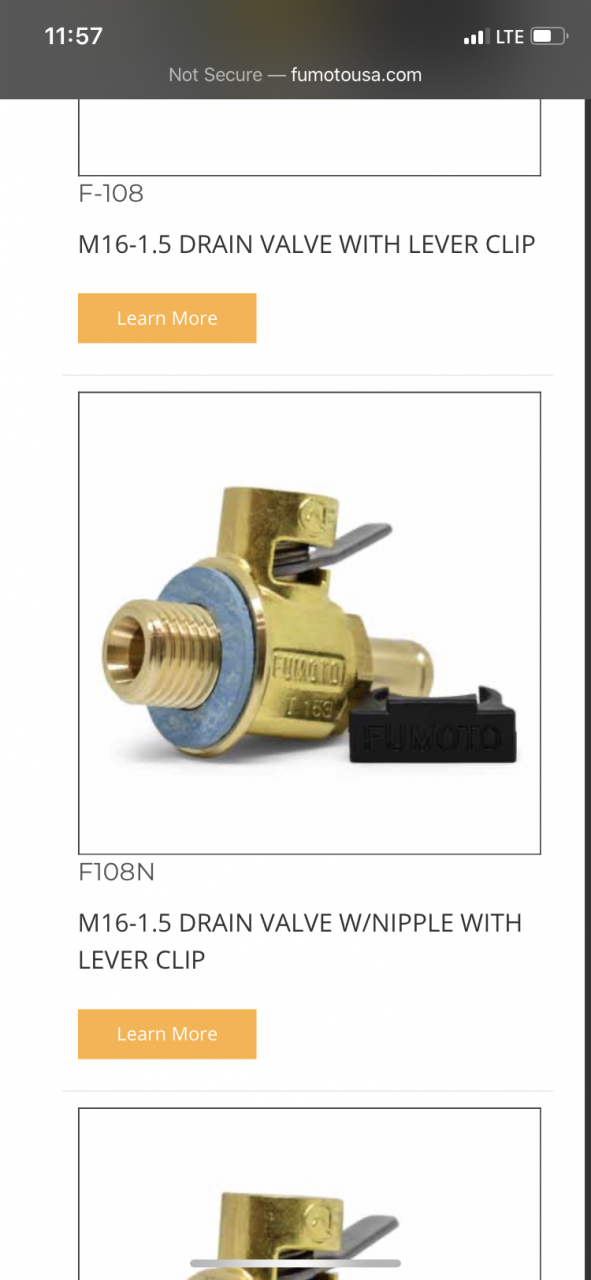

    1683DC89-9A64-4D7E-894B-40B9E7B73BAC.png 5006D556-C690-4157-BF51-CB8FB090B285.jpeg Might want to check your engine tag, but this is the one according to the website.
    KB3MMX and Canadianhauler21 Thank this.

    It should be a m12x1.25 drain plug so ...
    fumoto model f103N is what we use but you may need to get f103sx.
    the SX is a swivel model and some engines will have limited access.
    most of the reefers use the same drain plug.
    KB3MMX Thanks this.
