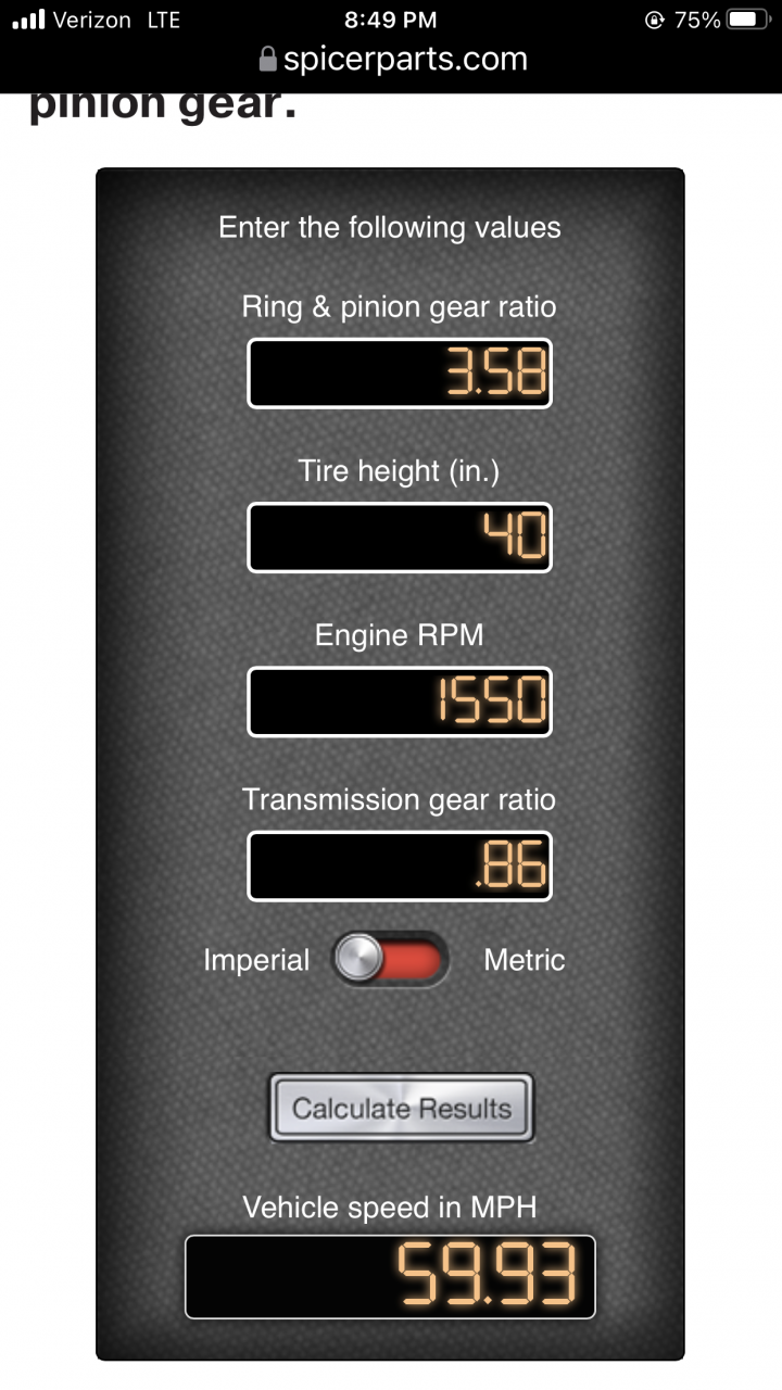

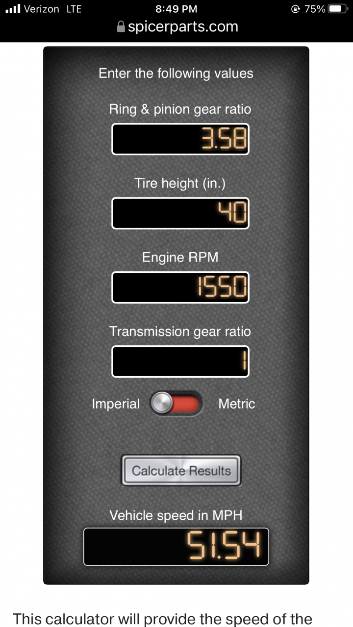

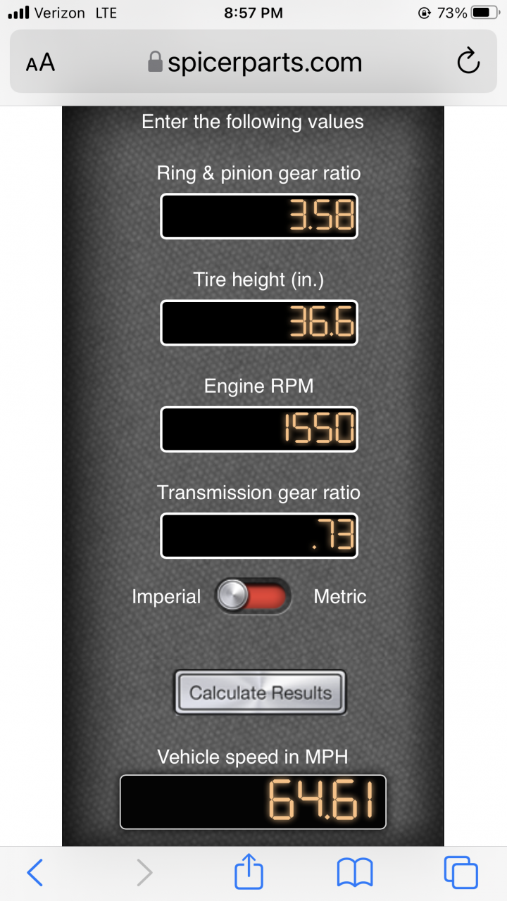

    I might have just figured it out. He might be running 255/70/22.5 which is spot on with his numbers. Try starting the transmission out in 2nd gear and determine if you can live with it PERMANENTLY. If you can, 2.64 gears will put you exactly the same only in 9th gear. Cheaper to try taller rubber. My first 3 screen shots are with 295/75/22.5 DA33C9B8-F0BC-47F4-A83B-1BC3143C7884.png
