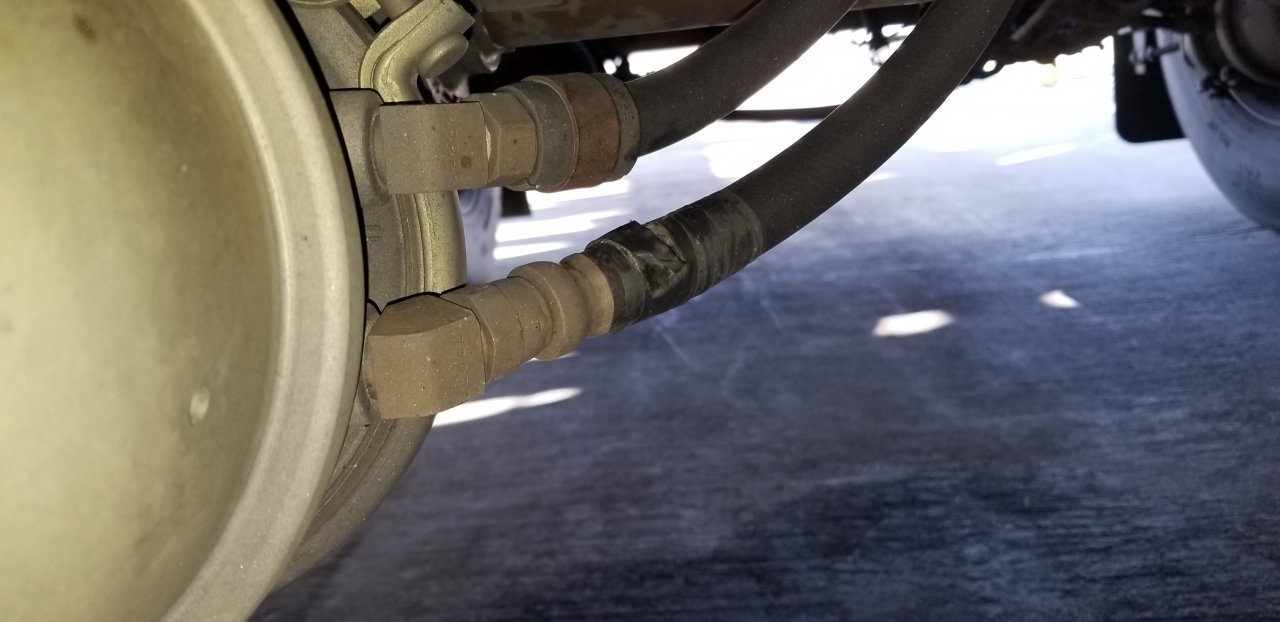

    I got almost the same thing as you, 5/28/19. Early, IA scale. Level 2 waltz around. We go inside & he says "everything is good EXCEPT, axle 2 right side, your air hose is rubbing the frame." Can you show me please.? "It's not going to cost you any $, just ziptie a piece of rubber on there when you get a chance." Bullspit, I look at the hose & it's a good 1/2" from the frame. I put a chafing protector hose around it for good measure anyway last night. Is this going to hurt my CSA score..?
    Just noticed he wrote my destination wrong, supposed to say Carson, IA.. dope

    Yeppers. It's a CVSA violation so it will be on the companies CSA score and your PSP report. If you're the owner, then it might even hit your insurance on next renewal.
    I would DataQ it with pics of it not touching the frame. Likely won't do any good, but it's worth a shot.

    ####.. Yes, I am the company. This is my first violation of any kind, operating authority granted 02/2013. I don't know of DataQ, other than what you & others have posted in this thread. I will research & submit my challenge. Do I need a certified mechanic on my side, or just photos, & my statement..? Thank you..

    You want someone who is certified and overqualified person with a piece of paper to prove it. you can be overqualified without it and there could be problems with them accepting it. I have known better mechanics without it and the certified guys next door would come over ask for help on trouble shooting issues from the uneducated guy.
