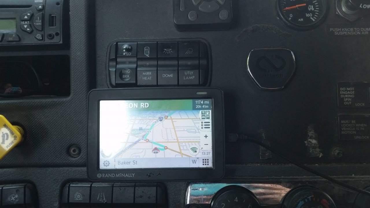

    Alright, guys and gals. A question for you CB wizards out there. Purchased a new CB and mirror mounted antenna for the truck, as we all know these internal factory antennas on the Cascadias are about worthless. The day after I installed everything I started getting a No GPS Signal on my Rand McNally GPS. It would freeze up for awhile and then reaquire the signal. Did this regularly throughout the day. Thought maybe the GPS was taking a dump so I bought a new one.
    Same model GPS as the old one, and after putting it on the windshield, it started doing the same thing. Started thinking it could be the coax I installed so I switched my CB back to the factory installed coax.
    Am I looking at a coax issue or an antenna ground issue here? Any help would be appreciated. Thanks!

    I would suspect more a ground issue. The GPS antenna on the 730 is on the top. I suspect you have spurious RF floating around.

    I have seen wiring harnesses with the Collision Avoidance system, Tire Monitoring systems, Dash Cams, RF Transmitters (kind to hook a device to your radio), CB mounting all interfere with a GPS device. 99.999% of the time it is grounding on the other device.

    Is anything close to the GPS? Move all non GPS wires away and provide 6" of clearance from other electronics.
    If my Bluetooth earpiece is charging and gets within 3" of my GPS it will lose the signal until I move it farther away.

    I've been experiencing loss of GPS a lot lately. Nothing really changed in my truck. I'll watch the GPS diagnostic screen and have 0 signal from any satellite. Sometimes for an hour and miles. Then randomly I'll have them all again almost full strength and 8 foot accuracy. No clue what's causing it. I've had it in its current position for a while now and this is a issue.
