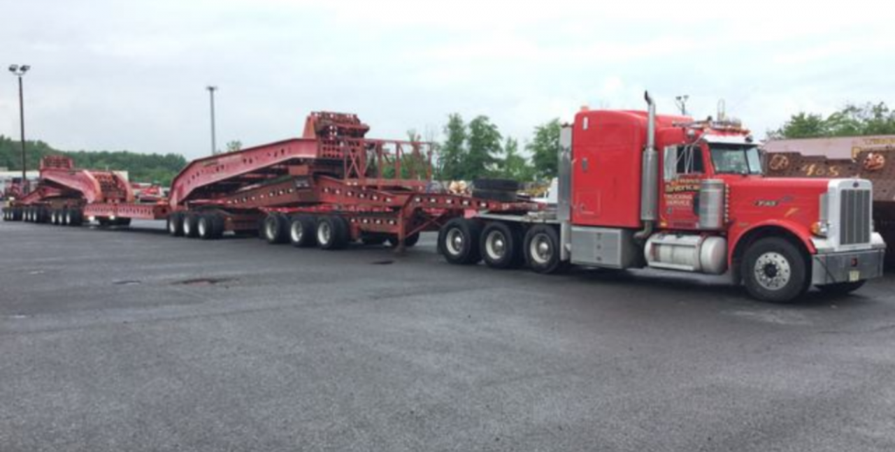

    Drivers that run this type of equipment, do they stay busy running trailers this large? Are they usually out months at a time ? It would be interesting to see what it's like to be a real heavy hauler. Screenshot_20200312-162808.png

    There will be an entire team of people running that set up - driver steerman pilot cars service trucks push trucks plus all the behind the scenes people who are In Charge of routing and permitting. So usually they are salary guys - I only know one guy who worked a 19 axle and he said it was an enormous pain in the ###. I believe they will change crews from time to time- especially if they have a significant delay like weeks or longer.
    This is equipment run by a Heavy Haul project company like Miller or Turner

    Our company runs two 19 axle trailers. While they do sit idle weeks at a time. One decent load makes it worthwhile. (My truck isn't big enough to pull em). It's typically a team operation and then there is police escorts involved. PA will bring their own portable scales so things need to be right. We have a driver that has all the steering controls in his cab. And is pretty much able to steer most of it unless it's a tight spot.

    They're pretty busy, particularly in the northeast where there are not many companies capable of hauling superloads or even getting permitted for them. Usually not out months at a time, just a week or two. Lots of short runs as well, big stuff coming in from the port that needs to be put in storage until delivery.
    The trailer in OP's photo is a Trail King that had a major overhaul couple years ago. That was one hell of a trip, NJ to SD and back. It took months.

    You pulled that #### thing?
