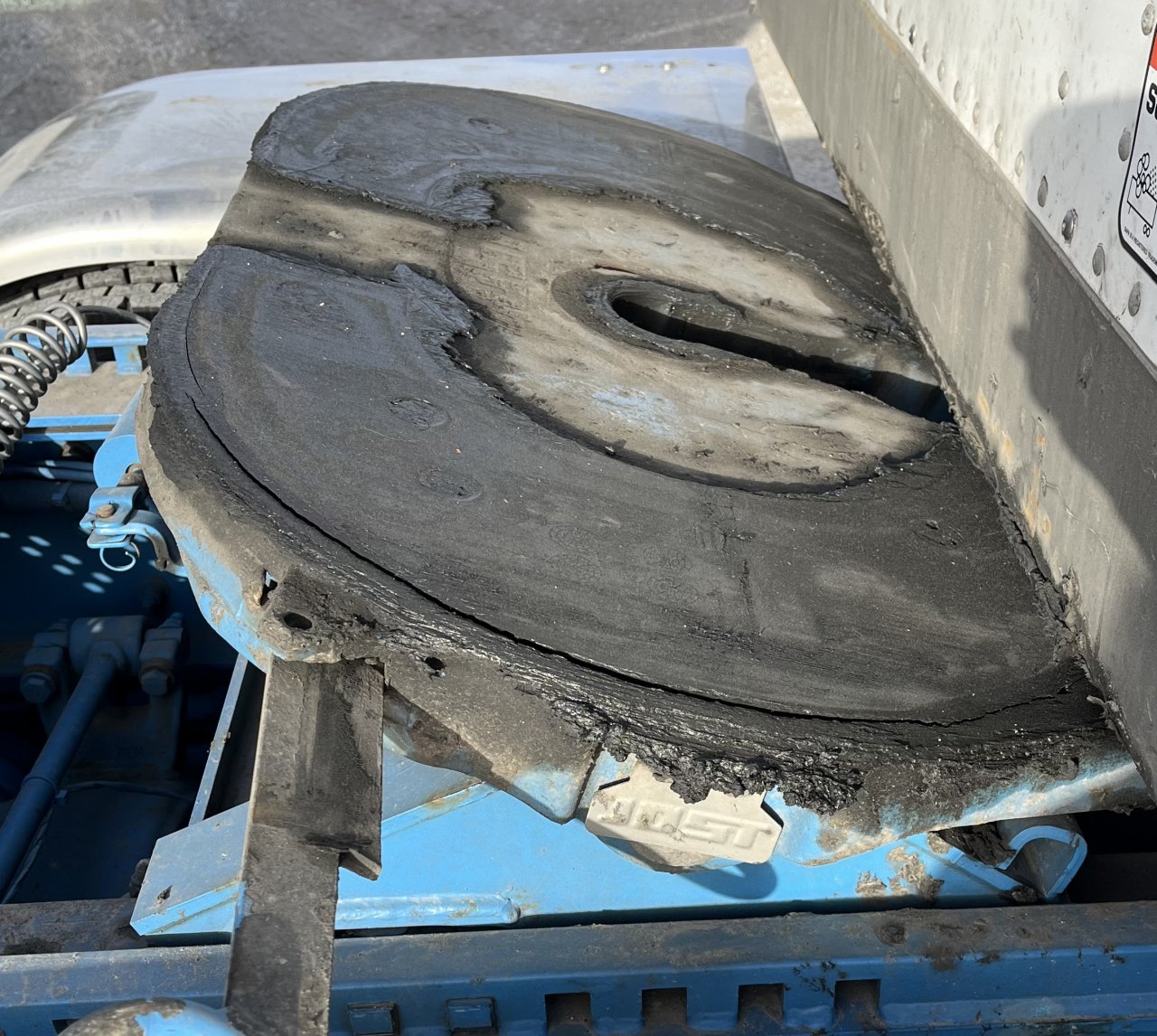

    Did you check the coupling when you hooked up?

    Yep, I'm going with parked at the fuel island.

    I'm going with sabotage. Pilots have cameras all over, and I bet you'll see someone had an axe to grind with Werner. With the way things are today, I bet nobody even noticed someone pulling the pin. If you made it that far, and didn't lose it, that rules out high hook, as I'm sure you turned to get into the truck stop. Unless you picked up the trailer at the Pilot, it's unlikely anything you did. Hauling rail cans, that upset a lot of folks too, and not unheard of guys losing rail cans leaving a truck stop. It's why everytime I put it in gear, I pulled the Johnny Bar, just in case. I bet you will too from now on. With their turnover, I'm sure Werner pixxed off a lot of people over the years. Not rocket science. No question, sabotage.;)

    That pic looked like it was high hooked. When he backed under trailer, the fifth wheel went all the way past the pin. Then when he pulled forward the pin was in front of the fifth wheel. Tug test would have felt like it was hooked. I've seen some go some miles like this before the trailer slid off on a turn.

    It’s a no lube top plate. Surprising that a company doing a lot of drop and hook is running them as the plates get busted up from slamming under trailers that are too low. I loved my no lube plates when I was pulling the same trailer all the time. Now that I drop and hook a lot, not so much.

    Run one a them $20 buck slick disc on my step. They are awesome as long as gentle while coupling.
    Was quite sad 1st time I had to grease up to pull other people's wagons..

    Here’s how mine looks. It’s not ideal for drop and hook when the company uses grease but as long as you’re gentle getting under trailers and clean the grit from the teflon if you bobtail they last quite a while. I’ve replaced mine once since new.
