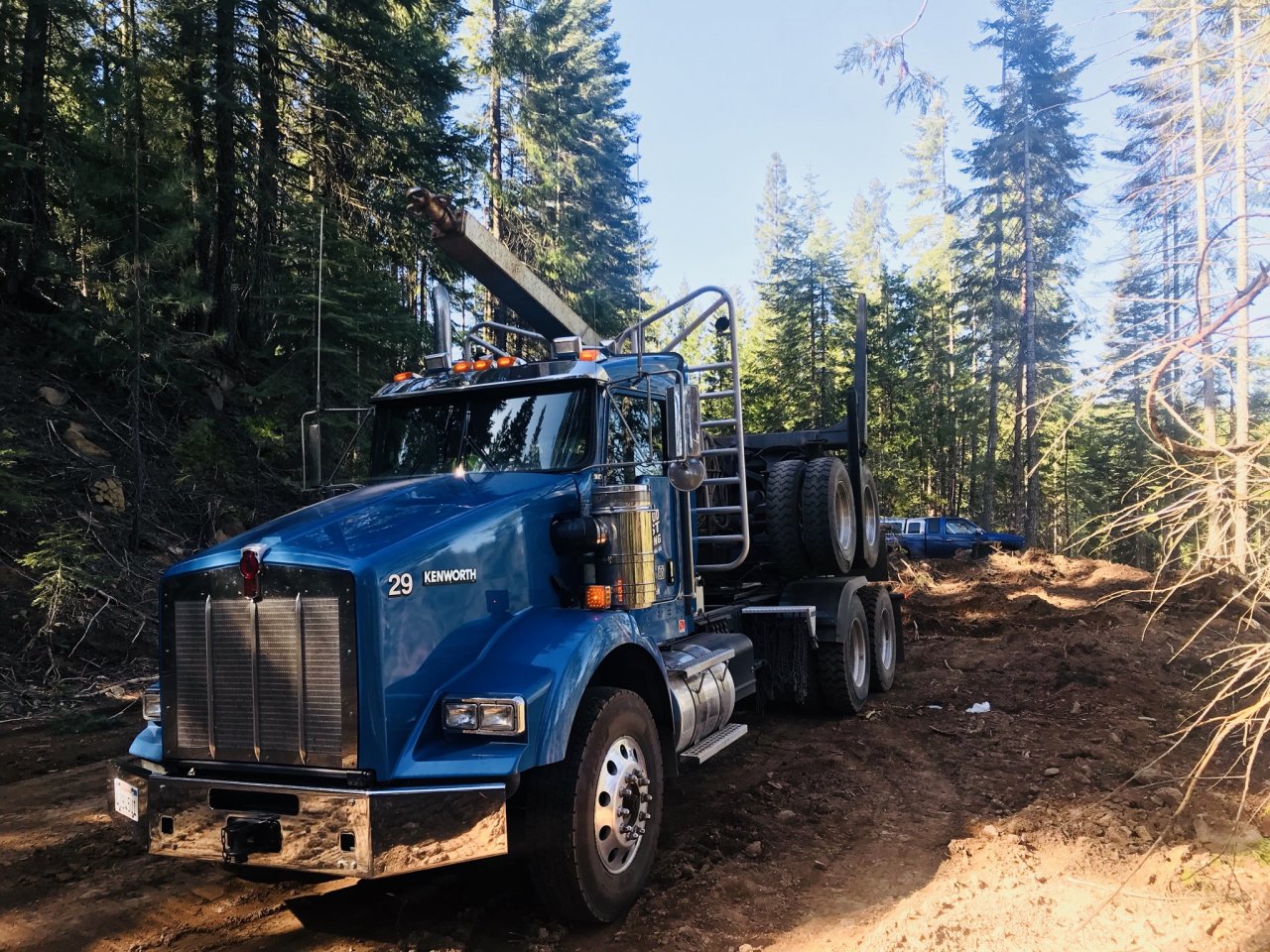

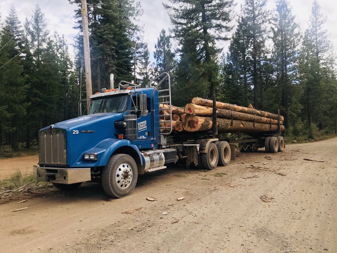

    878E414A-40E1-4002-8F3D-E263CAD21C0F.jpeg 3A6D39F1-755B-48FD-A476-89D992DEF33B.jpeg This is more my style these days.
