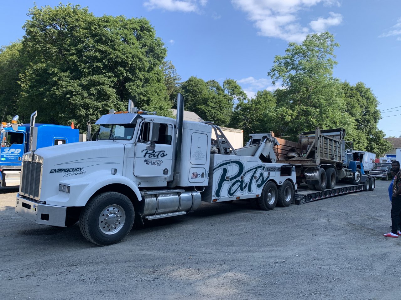

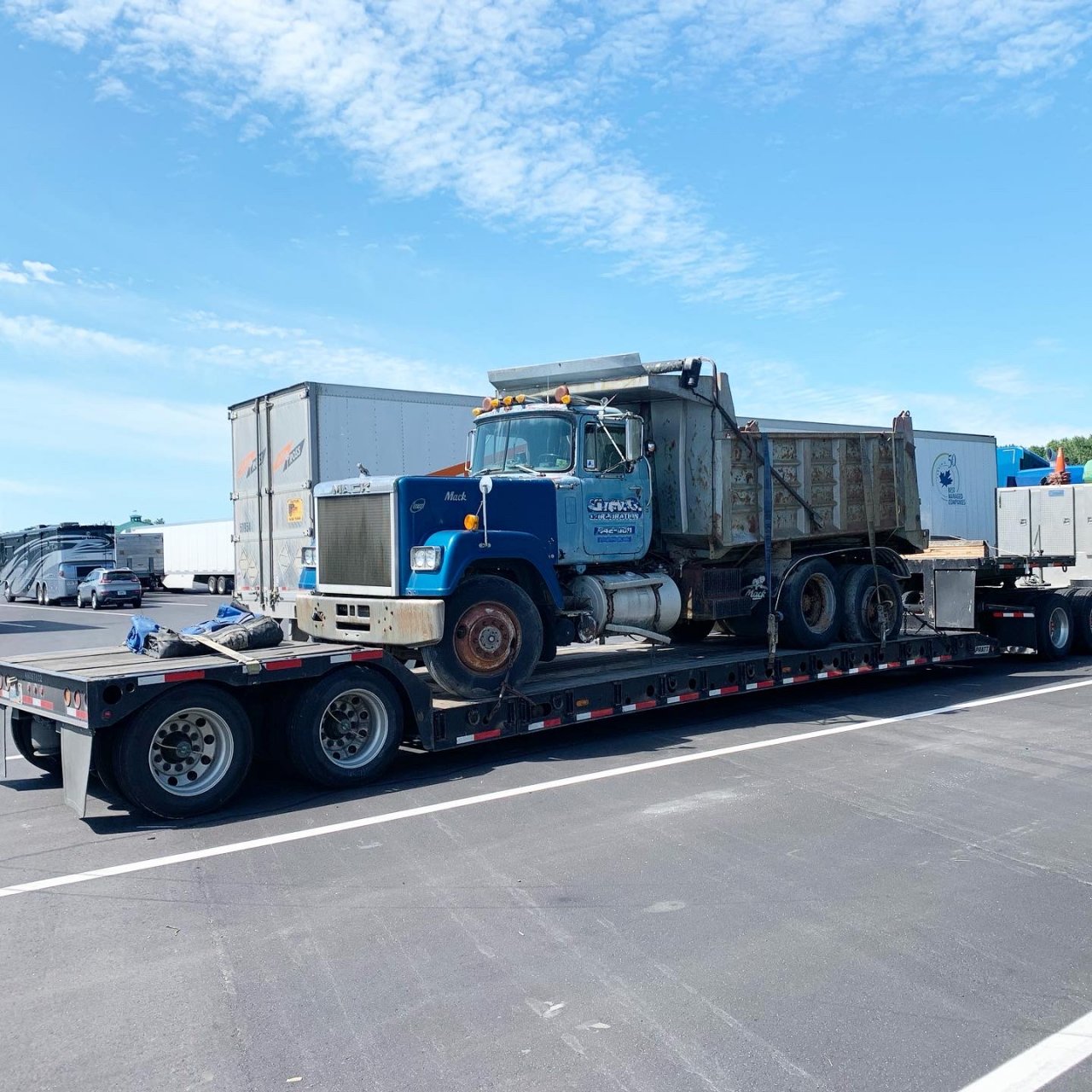

    My winch tractor loaded the double drop with it no problems. We put a fair lead at the back of the neck and chained the neck to the frame of the truck if the cable was out over it.
