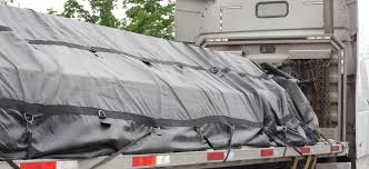

    Only a couple 1000s of pounds, but you don’t have to tarp it..mostly
    Weight is weight more axles, helps to know weight of load, not going to cat scale that one
