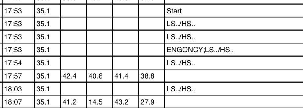

    Had a load of product arrive super hot recently. I believe the reefer was run on cycle instead of continuous.
    I was able to get a download of the reefer log but I’m trying to interpret some of the event codes. The reason I’m sure it was on cycle is this (or something similar) appears 50 times during the 4 day transit. “Start” is pretty clear that the unit is starting. What do the other things stand for? “LS../HS..” = ?? and “ENGOFCY” = Cycle ??

    Sample

    Low speed/high speed engine on, cycle sentry

    Thank you.
