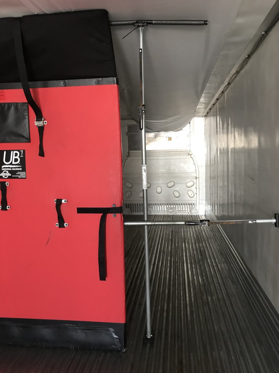

    016DA567-0FDE-43D1-BAEA-6A4C17603847.jpeg This is how I set up for my first pick.

    Same here. Its a separate unit on the trailer nose which has a sensor inside the trailer that looks like a steel cylinder. The donor locations print out a current value slip at every pick up. I think its called a Euroscan.. Or an Ameriscan.
    We have a banana bar that goes across the top, and we stack the pallets straight as possible in front of the bulkhead in left side. Then loadlocks are used behind it. That way the staging area isnt as cold so we can stack and wrap inside trailer without worrying about coats. The larger doors are never opened, we have a mini door open and toss them in. Most pick ups are in dense commercial areas like dollar generals and such.
