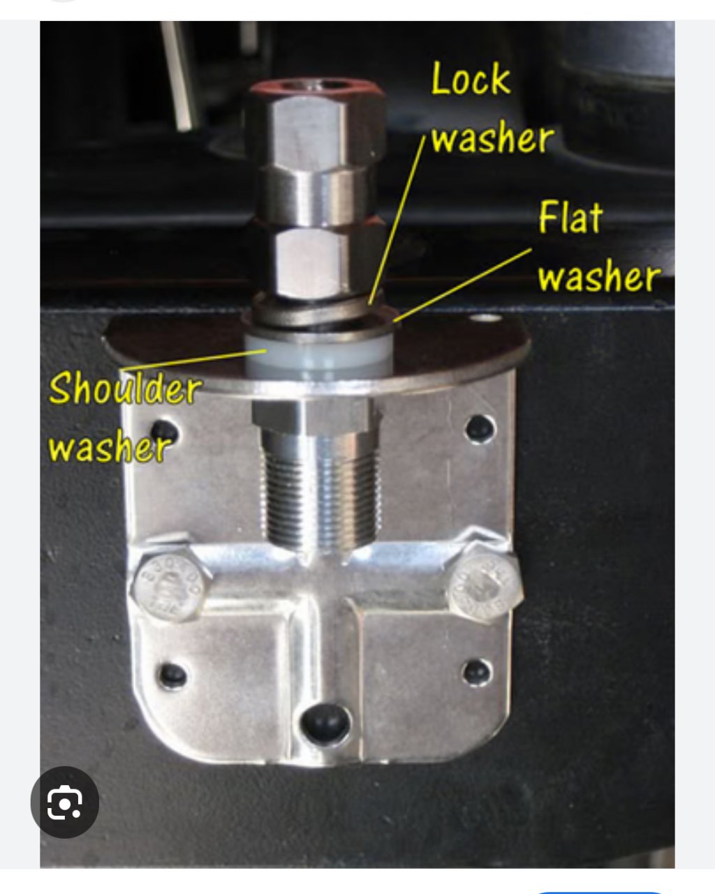

    IMG_6144.jpeg Not trying to put you on the spot, but did you put the nylon washer back on the right spot on the mount ?

    no i didn’t. Switched it around and no effect

    I’m beginning to think it’s the mount i bought, or it’s just my radios giving erroneous information. I’ve had it connected to the stock antenna all morning and SWR’s were where they were supposed to be at. For no obvious reason a few hours later they’re back up over two according to my radio, and i never touched it

    What kind of mount?
    Most likely the grounds - RF - don't exist with the new system.
