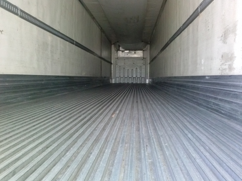

    Really? Maybe that's why they're out of business. First trailer I bought was a 2000 Trailmobile, before I knew better. Never again. The good news is that there's enough out there that break a lot, so parts dealers are usually well stocked.
    On that one (got rid of it this past summer) the floor was going bad. Not worth fixing. It had an '04 Carrier XTC with nearly 20k engine hours still running like a rock star. The guy I sold it to had two more Trailmobiles in his fleet and took it for a spare reefer and trailer parts.

    Certainly everyone is going to going to have different experiences with different brands of trailers. The Trailmobile we own, is still going strong. We have put well over a million miles on this trailer. We did install a new unit in 2011 due to C.A.R.B and worries of being fined. The '99 unit ran just fine. As far as the floor, we did have it checked and to our surprise, the crossmembers are NOT made of wood. They are a bone colored plastic composite i-beam. For parts, well the suspension is Hendrickson, which can be purchased @ any trailer parts house. Brakes are common as any other brake system. Trailer doors still close tight and seal great. We own a new Great Dane with a Hendrickson suspension and brakes look the same. Both trailers make same noise as forklift goes in and out.
