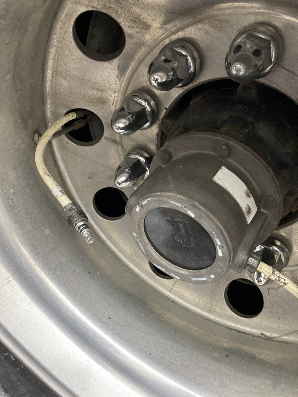

    You would have to disconnect each air line in turn and check the tire with a gauge. And yes, of course each tire does have a valve stem. You just need to look harder.
    The tire inflation system will keep the tires aired up to a set pressure so why do you need to mess with them? If you're just looking for reassurance then you could buy a TPMS and insert a transponder between each valve stem and each inflator line. Just a waste of money if you ask me though.

  7. Short Fuse EOD
    Short Fuse EOD Road Train Member
    2,774
    8,667
    Jul 29, 2015
    Midwest
    It’s no harder than unscrewing a stem cap. It’s meant to be done. I’m not even sure it takes a single second longer. I can check all trailer tires in 3 minutes or less. I got out of my sleeper while we are chatting here to show how easy and quick. But to each their own. I’d rather check psi every now and then rather that blow a tire.

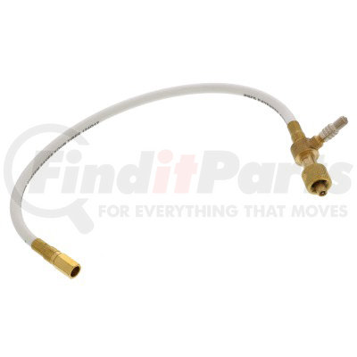

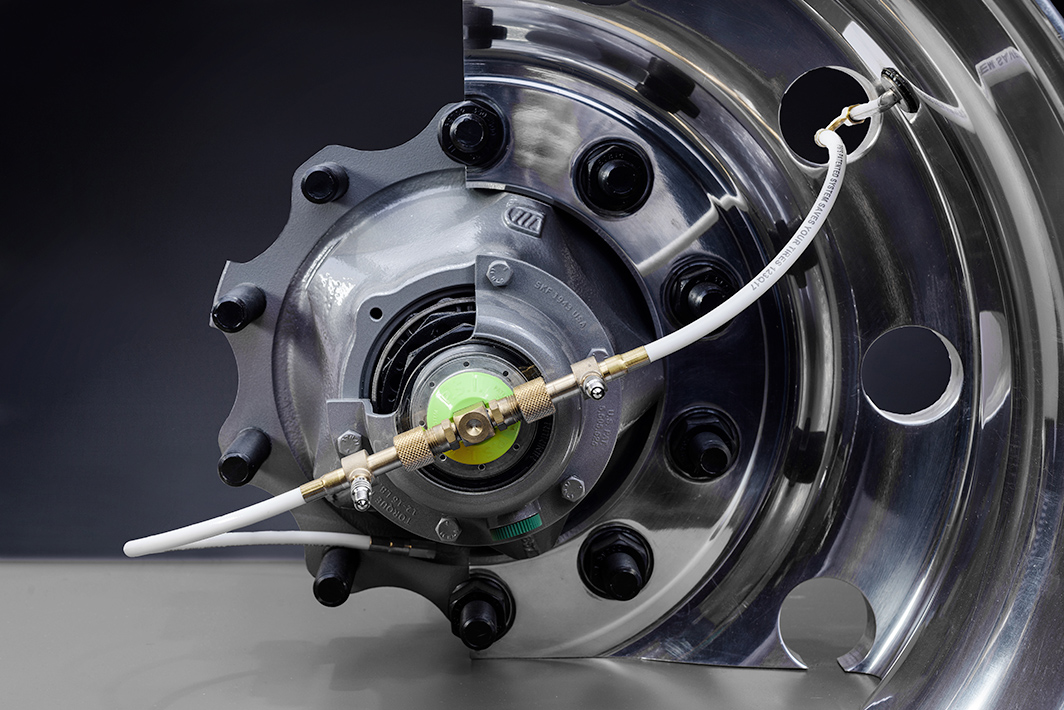

  9. kylefitzy
    kylefitzy Road Train Member
    4,653
    19,265
    Aug 12, 2007
    Kansas city,Mo
    They make systems with external valve stems. 6D201BF8-A9B4-47BC-B6FD-4414D6DEFF69.jpeg 11C605FC-6000-4B20-AD06-F6E5FBEAFB52.jpeg
