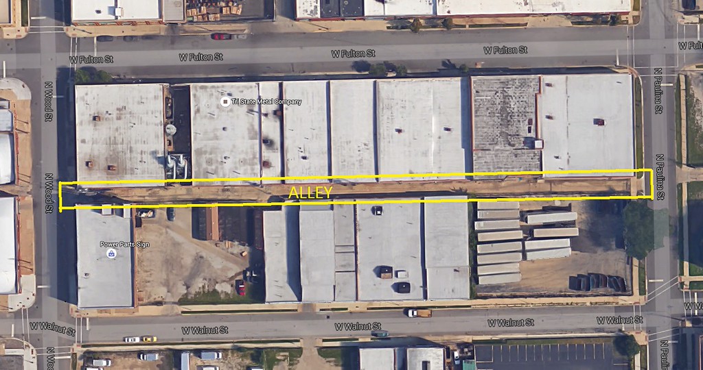

    Chicago alleys are 16 feet wide. Here you can see one, with some trailers for reference. Not even the most super-est trucker is turning a trailer in one of these.
