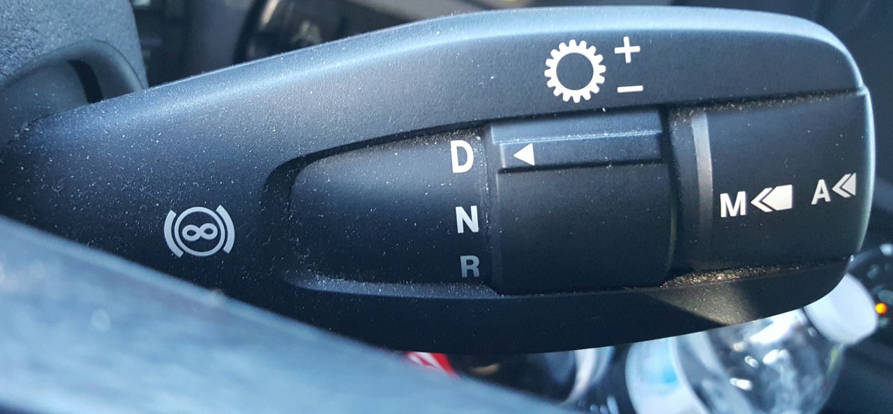

    That image put a smile on my face to start the day... Thank you... :)

    Don't know nothing about all them gears. I just put it in drive.

    Yup, just had flashbacks to CDL School... lol
