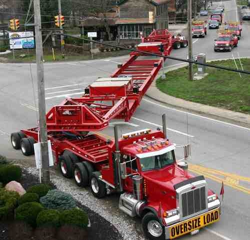

    I like this picture. You will hear me often talk about how heavyhaulers develop a certain finesse behind the wheel. It's not something that many people think about because of the term "HEAVY HAUL."
    But these guys are running trucks with big engines. Big loads. Big trailers. And it's a game of inches. Nervous? Nope. Just another day at the office.
    Here's a couple trivia questions for those of you that are interested in OSOW.
    1.The truck in the picture, if he were moving when the picture was snapped, what gear would you think he would be in and why?
    2.How many spotters does he have?
    Keep in mind, there's no wrong answer...just picking your brain.
