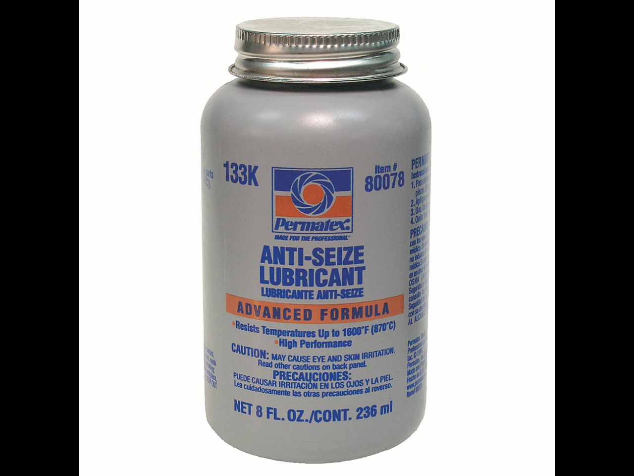

    Once you get it freed up, this may prevent it from happening again.
