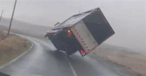

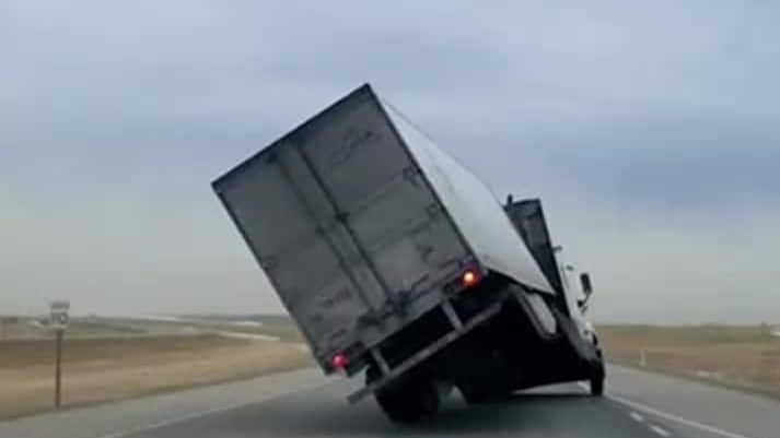

    You are comparing apples to oranges here. My post was talking about how crosswinds 'affect the stability of the rig depending on tandem location'. It said NOTHING about preventing a trailer from being completely blown-over. The picture you are using for what I assume you consider to be some sort of "proof" show a trailer already blown-asunder to an angle which is past recovery. Where the tandems were placed has no bearing on a situation like this at all. If you are too light, it's going over at a certain wind speed no matter what. And, BTW, of your pictures, #4 is a straight truck; drive axle placement is NOT adjustable.
    The picture you show is of a situation completely out of the driver's control; a wind velocity too strong on a trailer either laden too lightly or with a center of gravity too high to remain upright. In conditions as severe as this, my original suggestion of just parking the rig would be the one to follow.
