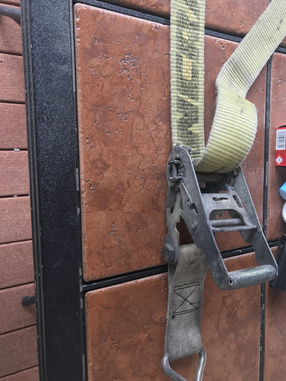

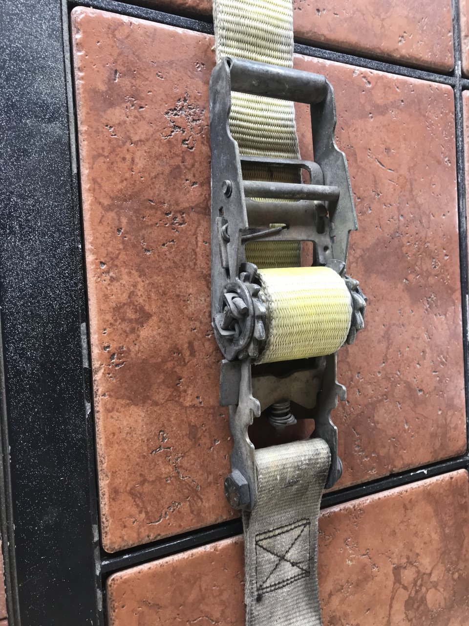

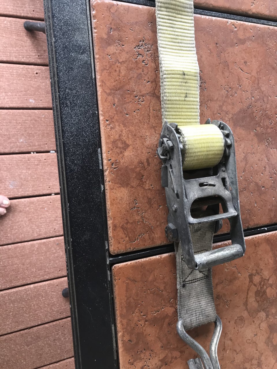

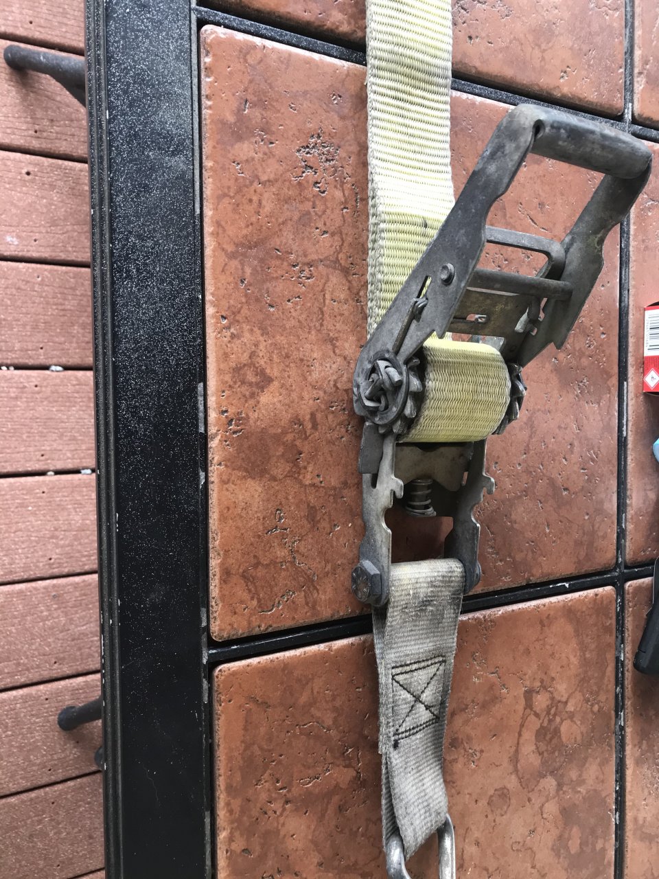

    Edit - in this example I’m ‘securing’ the table - or - the table is the deck of your skateboard.
    Open a little till slot is accessible, pass strap through from behind, and excess strap toward you then back over whatever you’re securing.
    Then click click click to tighten
    Close handle, secure excess - ready to roll.
    Open all the way to large notch to release.
    Pull strap - ratchet should rotate freely back to allow you to pull strap through, remove roll and store.

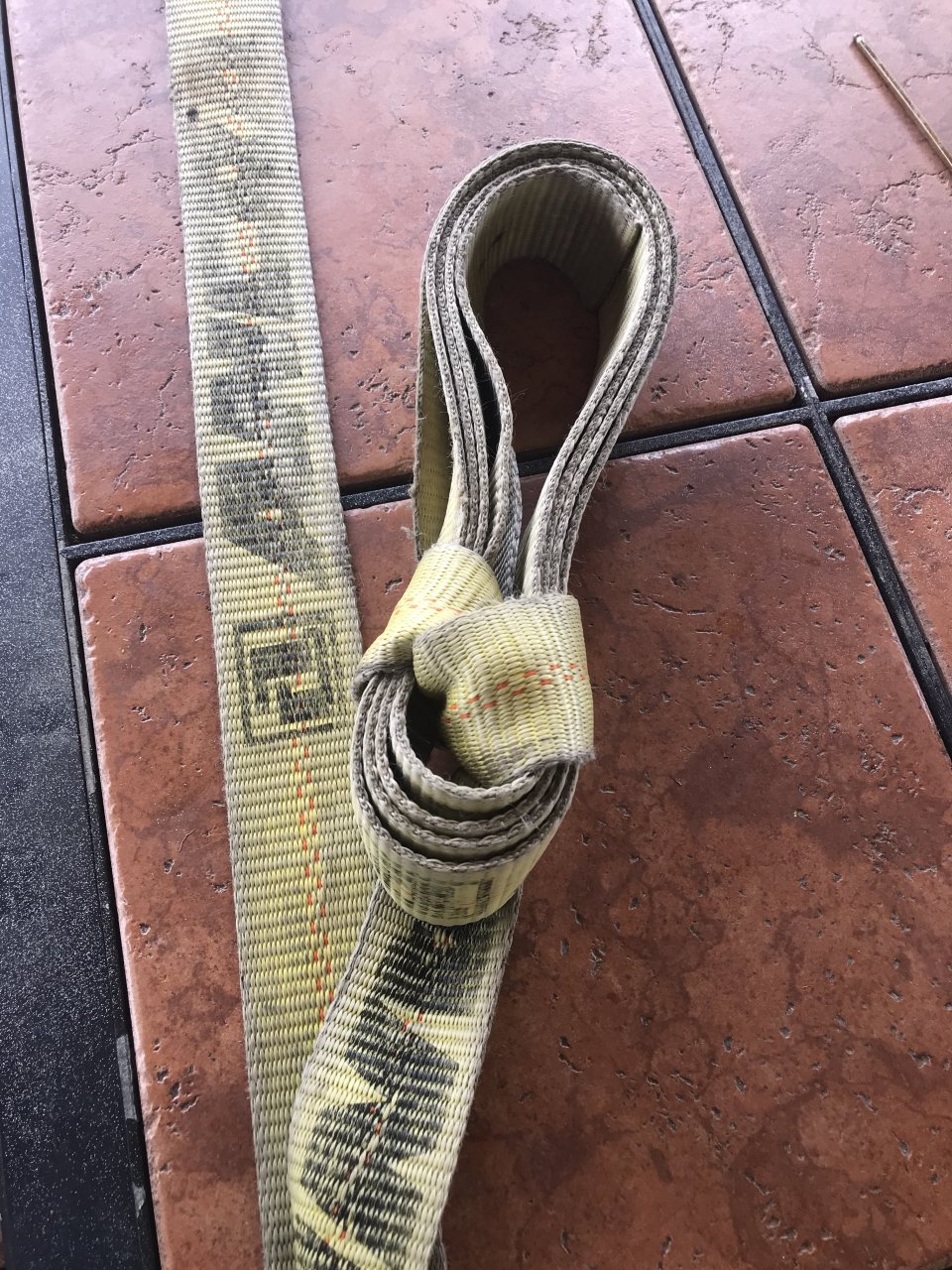

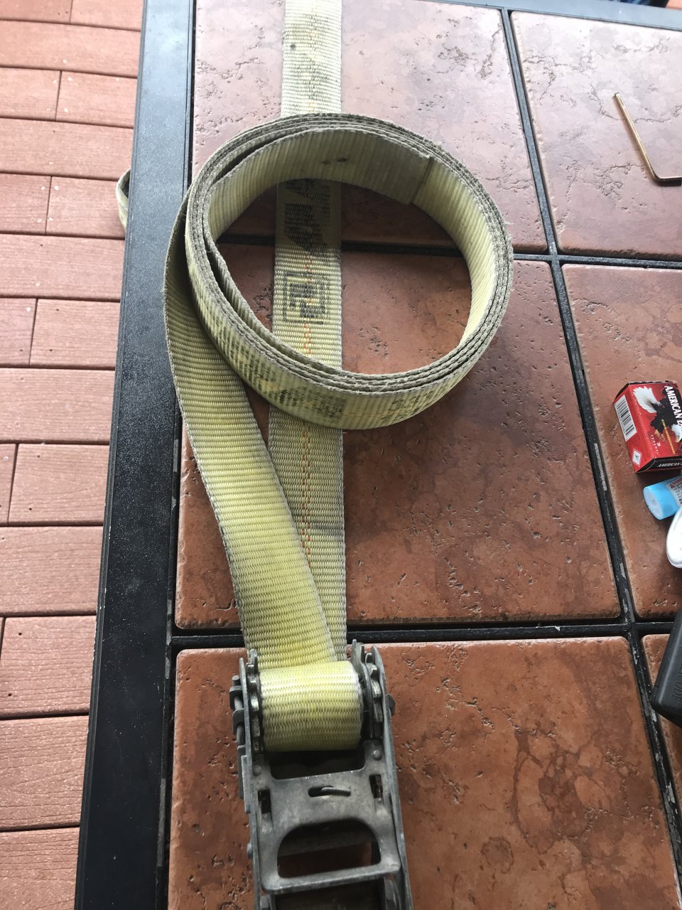

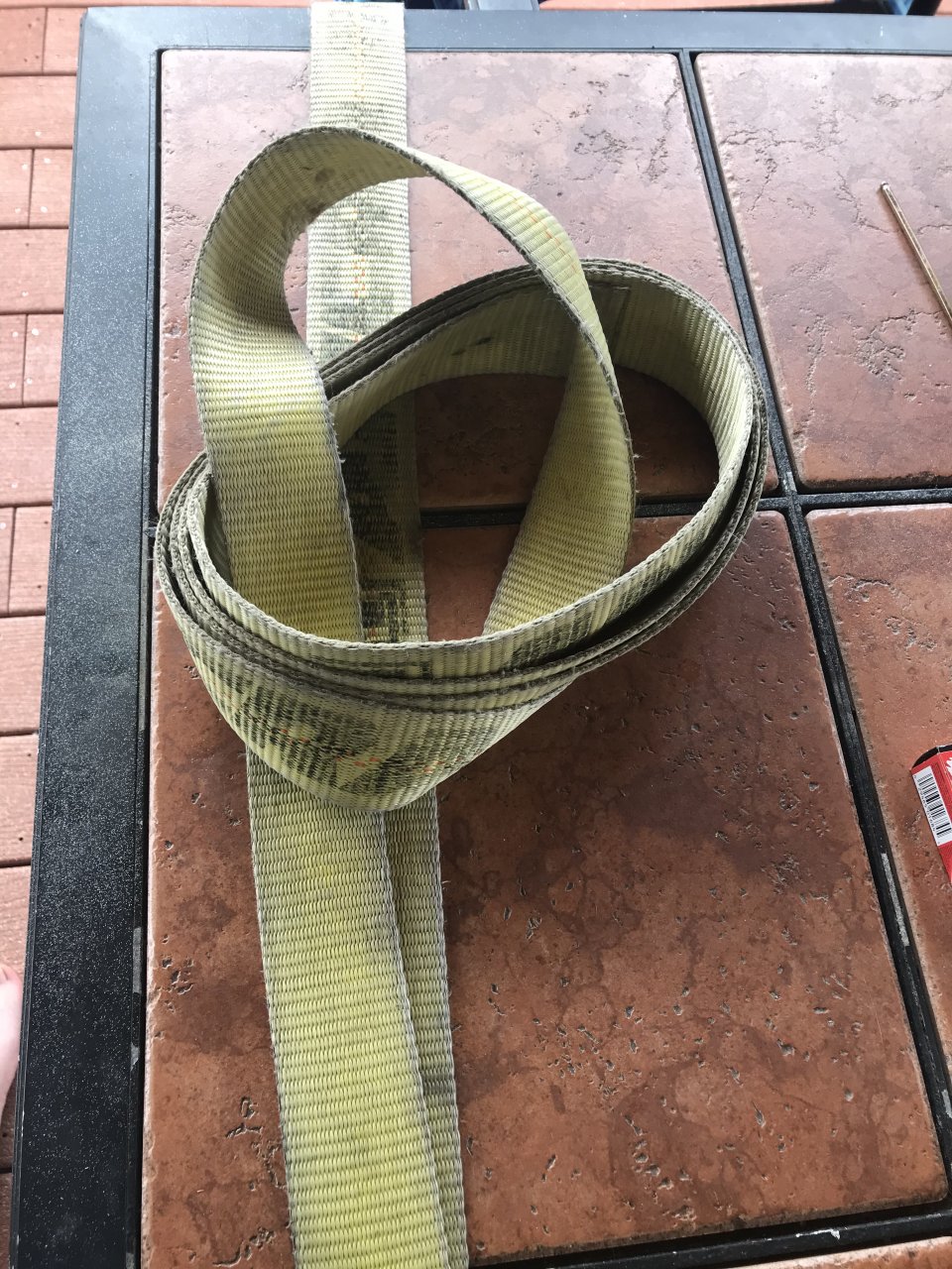

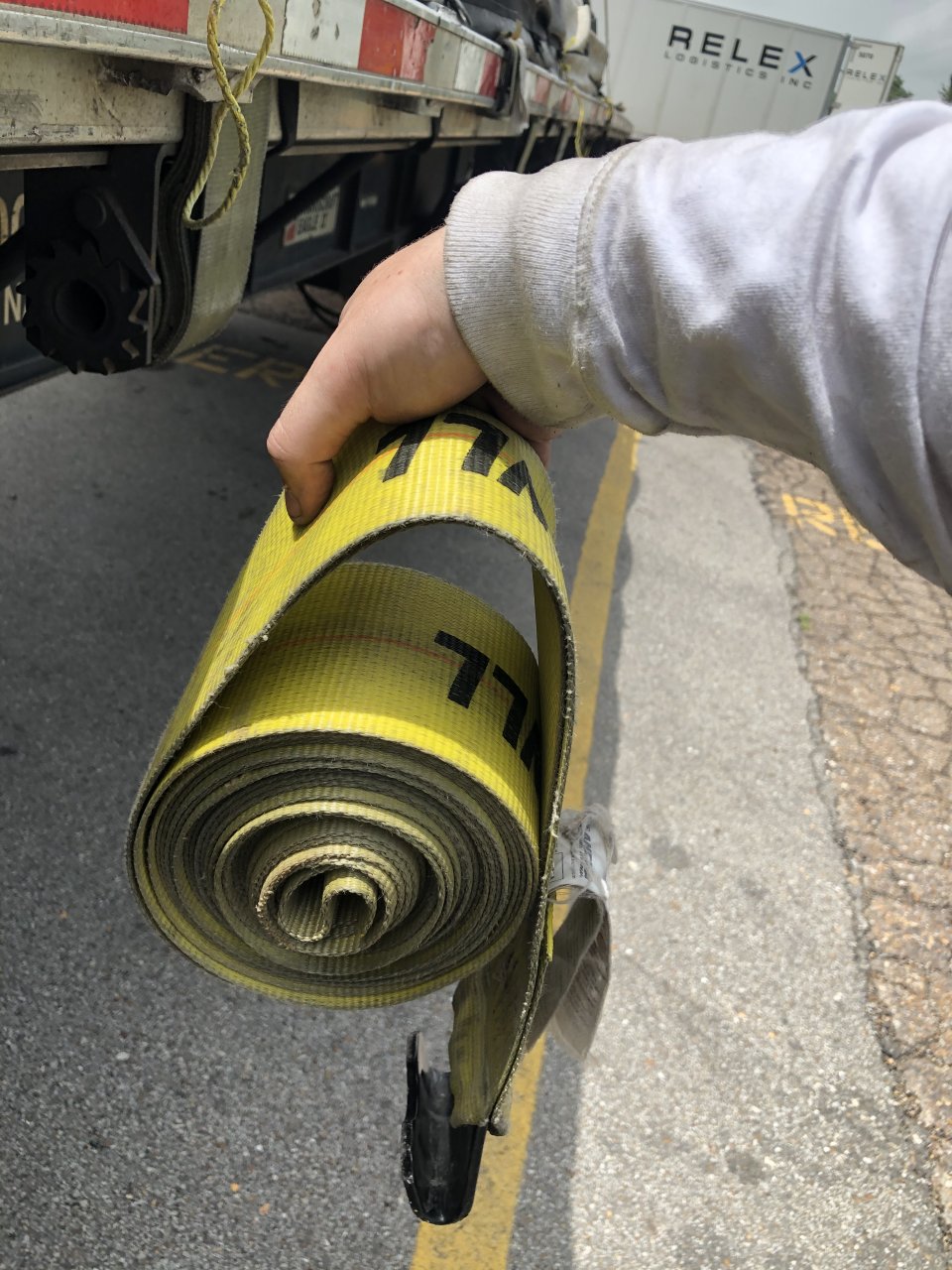

    Extra for experts - here’s how I store excess. Roll it up,
    Pass the last loop through the middle of the other loops.
    Pull tight and stuff in rub rail, behind tensioned strap, or bungee it .

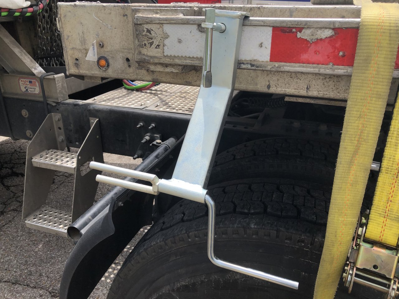

    Appreciate it greatly, gonna look at this in a minute in detail, practicing throwing my 4 inch straps lol until 20 or so minutes ago it took me about a minute to throw a strap and had a 50% chance of getting it right, now I found a new way that suits me and I’m throwing it about as fast as I can get in place with 90% success rate 9ACD9534-D0CF-4070-A146-FA4ED2E87124.jpeg 19DA0522-EC97-49A6-B91A-EC4FF753F893.jpeg

    Take that strap winder to a metal shop, have them weld a small rectangle on it where it slips over the rub rail.
    Measure it to the inside of the stake pocket. So it fits snug in the stake pocket. That way, you can remove that little bolt that damages your DOT reflective tape every time it’s tightened on the rub rail.
    You might not care because it’s a WE trailer, in which case you’ll have to install something in your mind called pride and professionalism, which will ultimately lead to something called success. :)
    I oughta shut my mouth - I’ll wind up having to go to the trailer and show you.

    My arms are kinda short compared to my large build so I had to one hand the strap to take the picture; I hold the hook with my left hand and throw with my right
