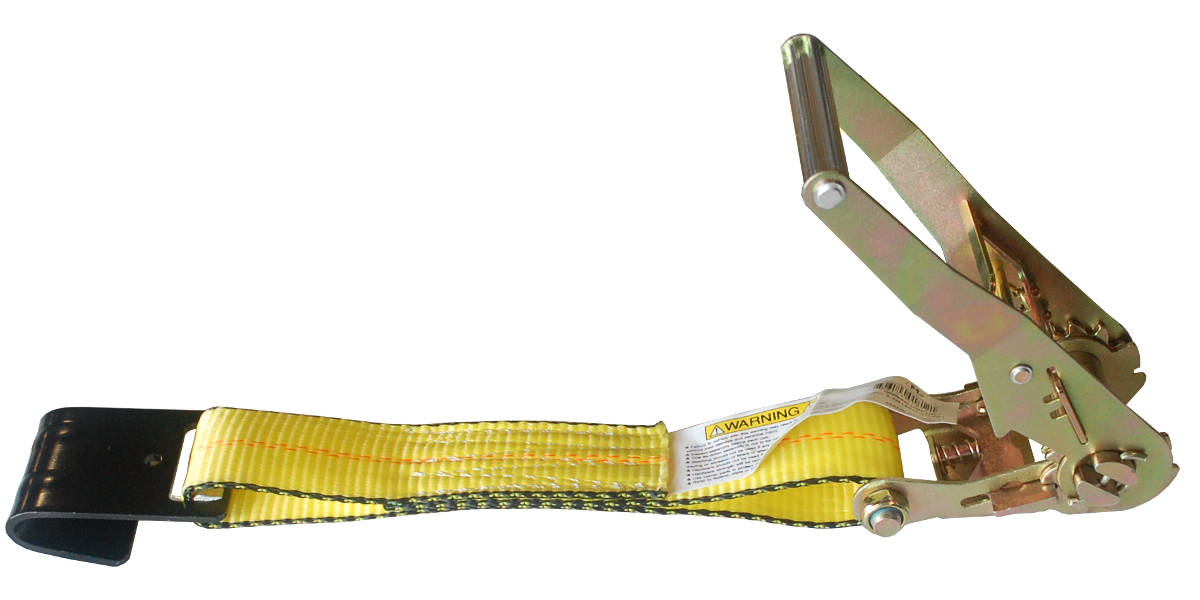

    Most of the 2 inch ratchets look like this.
    Take the nut and bolt holding the lead loop out, swap the lead loop around so the hook faces the opposite way, put bolt and nut back in place, make sure and get it tight.

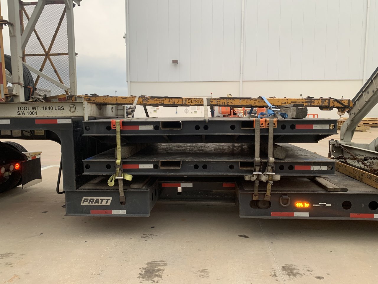

    i use this method to secure all my 2” straps. If the ratchet doesn’t have an opening in the strap I pass it on to one of our other drivers. 492C717F-CB68-4CFB-A6B2-91BC6319B790.jpeg
    Open the ratchet all the way, feed the strap in from the back side, snug the strap up, fold the excess up and tuck into ratchet, finish tightening ratchet. To undo just open the ratchet all the way, and pull on the excess strap to unroll the spool.
