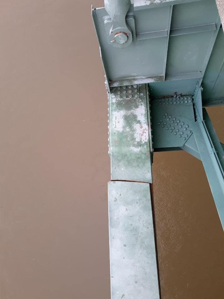

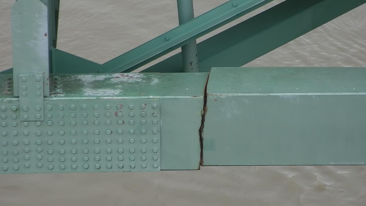

    That's a little more than a crack I'd say.
    That's a big deal...

    Just read an article that this was a routine check that they do every two years. Crack was so bad that the inspection crew called 911 and they had i-40 closed within about ten minutes. Sounds like a catastrophic event was narrowly missed. They’ve shut down barge traffic on the Mississippi as well.

    That's not carrying the traffic load. Most all of the vertical load is handled by the arch and suspension cables and directed into the piers. That beam is there to stabilize those huge crossbeams, and probably takes some good loads as traffic accelerates or decelerate. If you've ever been on a bridge in stop and go traffic, that fore and aft shaking (especially from heavy trucks taking off from a stop) would generate separation and twisting forces between those crossbeams that'd load that member. I bet that beam takes some hellacious wind loading, too.
