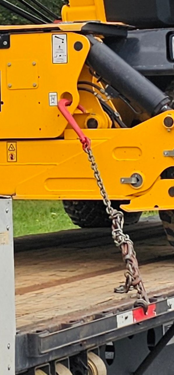

    If you're looking for something like this you we get them from a place that sells wreckers , there is multiple length and weight rated to choose from. Screenshot_20240607_051908_Gallery.jpg

    Thank you, but it is the plate that Blair mentioned.
