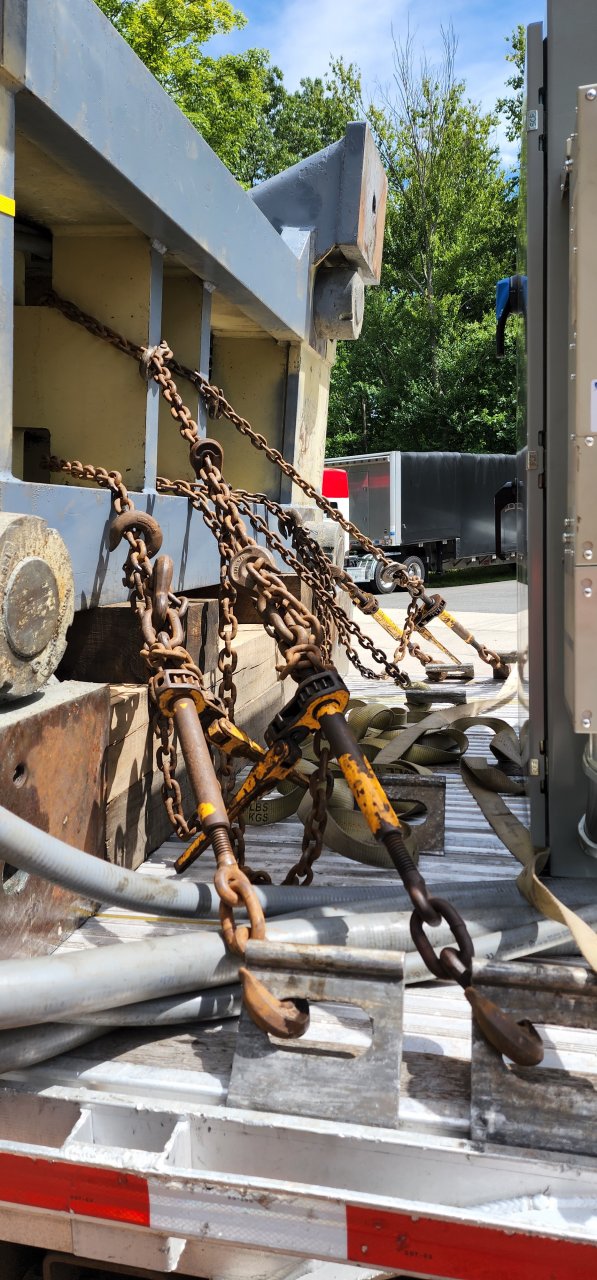

    I've used the 4 track setup to get more chains on a heavy press. I was able to get 12 chains on a press and pull in more directions to avoid fragile parts and secure in tight spaces. I have them for both of our Reitnours and 3/4 of our Bensons. Don't used them much though. Just not worth messing around with when I can just grab spools and pockets. I personally prefer chain pulls in the deck.
    This is 85,000 lbs.

    Is there a requirement for angle on the J plates, or do they lock up OK less than 45 degrees? Those seem to be fine.

    On the Bensons there are aluminum rods welded at intervals in the tracks to pull sideways against. On my Reitnours there's bolts sticking up from the bottom to pull against. You would have to shear off the 3/8" bolts to get those plates to slide. It's also why I used so many. I was able to move that 85,000 lb press with an aluminum 3 axle stepdeck. I personally wouldn't want to use more than a 3/8 chain with the plates. Both my reitnours and bensons have the same 6600lb rating for the tracks. Perfect for a 3/8 chain.
