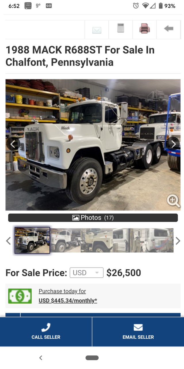

    I'd LOVE to go pick this up and bring it home to play with, but the wife says I can't. Maybe I could cancel my window replacement for the year....o_O Screenshot_20200215-065258.png
